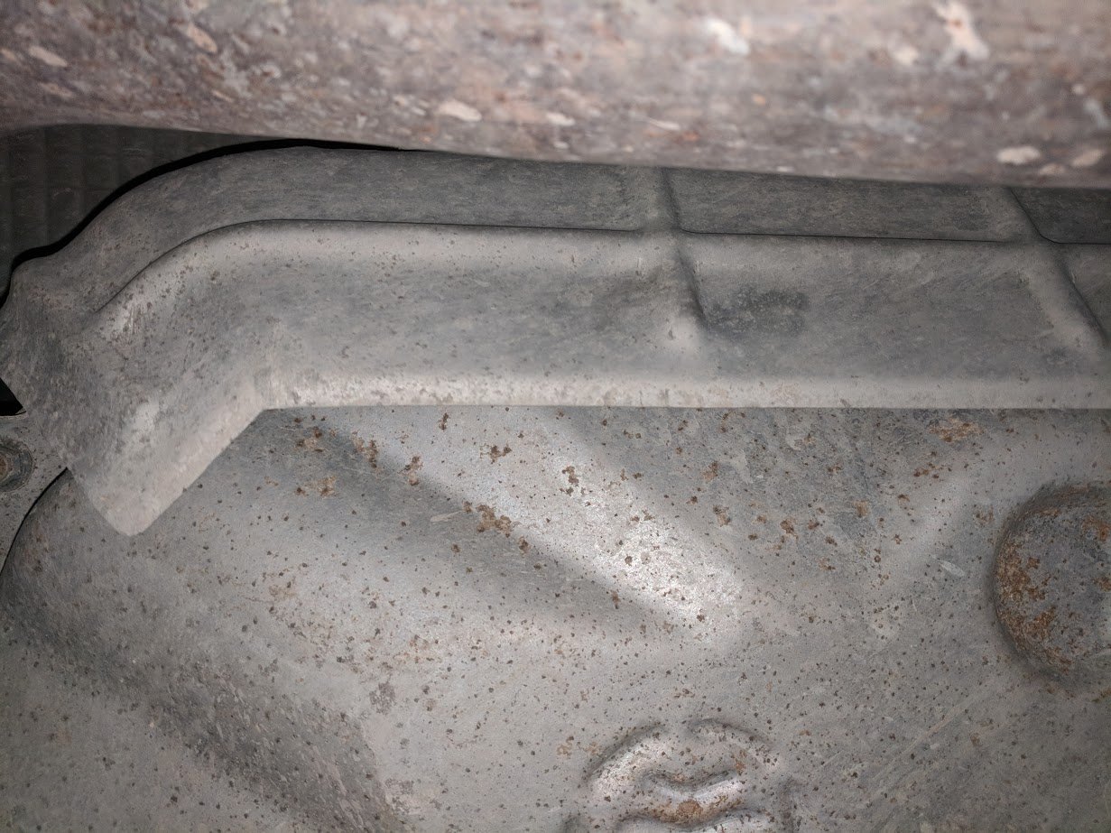

I have a 2005 Suburban with the 6.0L while trying to remove the transmission pan I noticed there is a heat shield cover on the passenger side. I haven't seen this in any of the tutorials or videos out there.
Can someone please tell me how to remove this cover? I couldn't find any screws to remove it and without removing it I can't access the transmission pan bolts on the passenger side...
Looks like you could bend it away. Also there should be 1 or 2 bolts on the side of the shield holding it on. Reach up and feel around for them

Well bending it did the trick. However now the car (4L80e) feels like it drives a little rough at all speeds. Completely fine at idle, shifts all feel smooth (revs acting normal) and reverse fine. But it feels a little rough just driving, like a slight shake at all speeds (not idle), hard to explain really.
