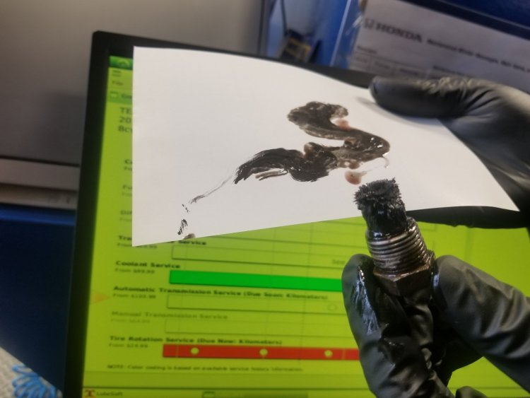

I just had the transfer case serviced (a little overdue as I'm at 66,000 km) and was surprised at how much metal filings were on the drain plug. Thank god the plug is magnetic. Anyways, I thought some may enjoy the picture.
Really? That's good to know. I expected some shavings, just not that much.

I think most of it is caused by the initial wear-in where everything is sharp and freshly machined. You get the same occurence in the differentials.
I've drained mine about every 25k since that initial time and nothing to speak of...I sit at 130k.

On my '09 I only changed the oil based fluids once (other than oil) and that sucker was still running like a champ at 240,000 km. My truck makes a little bit of a weird noise when in 4x4, so I thought I better do the service.
Any gear case, differential, transmission, etc., gets a lot of metal in it compared to an engine.

Not really, they just don't have a filter to remove it from the fluid...I posted pictures of the first oil filter from my 2017 Equinox with low miles on it (1500 miles IIRC), it was covered with metal shards and flakes.
