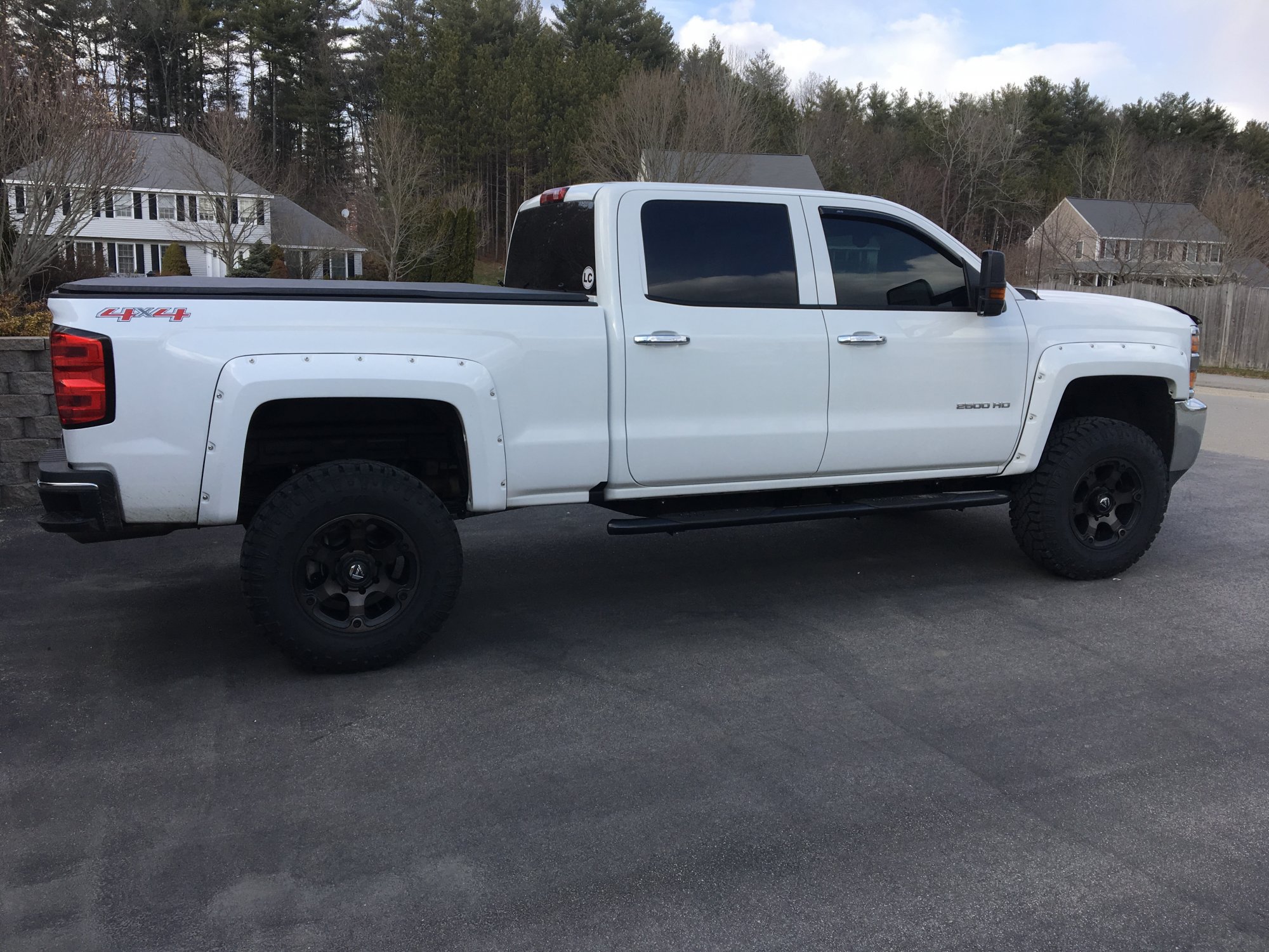

Hey, do you have picture of your truck from the nose looking down the side.

Not at the moment. I can do it when in get home from work.
Truck looks good, man. And yes, I'd say you need longer shocks, or something in the rear wasn't torqued properly when the rear blocks were installed.
Side note, what's your tire & wheel setup?

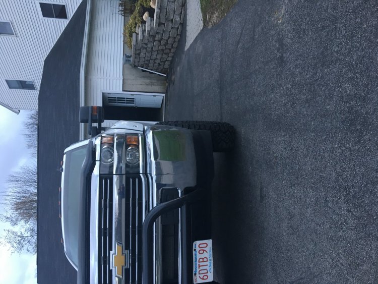

Sorry it took so long. And it’s sidewsys. Lol

Wheels are Fuel Beast 18x9. -18 offset.  Tires are Goodyear duratracs 285/75/18. Love the Duratracs. It’s what I run on my Jeep.

Sweet. Looks like the -18 offset works perfect with your fender flares. And I like that 285/75/18 size. Pretty cool to have a 35" tire without having to go super wide.
