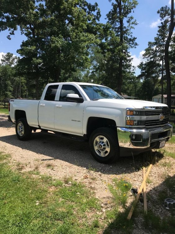

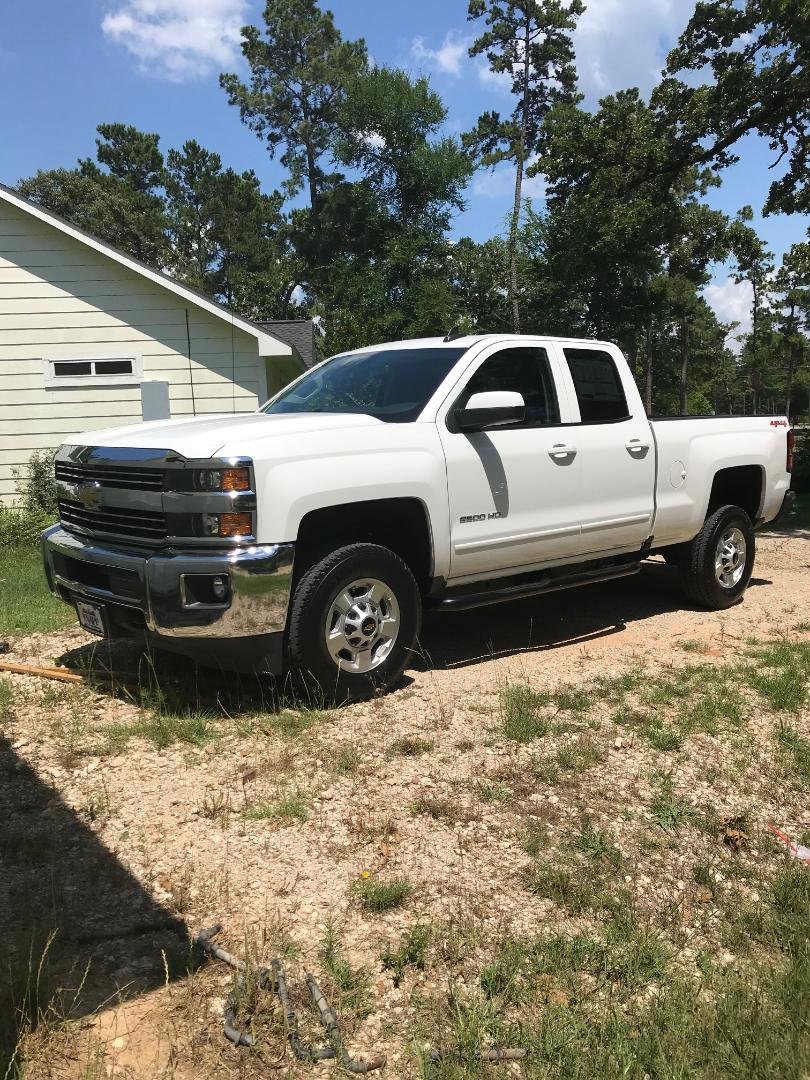

Hello... I'm a new signup, and new to truck ownership. I have a dilemma about new wheel purchase and tire size. Hoping someone can help.
I have done a lot of reading and research. I want to achieve a new wheel/tire setup for my 2017 Silverado 2500HD. I'd like to have a semi aggressive stance (about 1" out from fender). I am in contact with a sales person at customoffsets dot com.
With all that I have learned so far, it seems to me that I would like to upgrade wheels to 20x9  -12 offset, and put on some AT 285/60/20s. I am hoping for no trimming, and I believe the truck has a lift. Not positive because I don't know what to look for.
Can anyone advise me further? Attaching pic of my truck. Thank you.

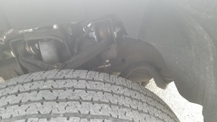

So here is my 2017. -15 20x9 with 295/60-20. I rubbed. I pushed my front bumper out 5/8” with spacer mod.
My tires physically measure 35x12.5

Nice Ride!! Looks great. My new tires would be 33 x 11.2. Maybe I could get away with that, no mods?
Congrats on the new truck!
It looks just like mine - mine's a 4x4.
Looks stock to me - no lift on it now, at least that's my humble opinion from the picture.
