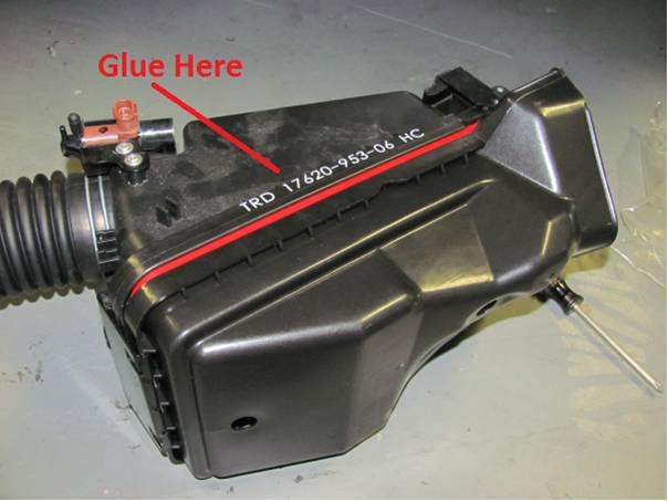

Like you, I never go to the dealer wither. I have seen problems like this before. Sometimes the seals/gaskets in the box dry out/shrink/crack/fail, and the water escapes before it exits through the drain tube. You may be able to use "gasket maker" to re-seal the box. It doesn't sound like your windshield seal is leaking, but that is another common cause. I have also seen blower air intake design flaws with TSB's.
Try this type of thing:
(I know, its an air filter box in the pic, but you get the idea)

I don't think you need to disassemble the box. Just find where the water is coming out and hit it with some sealer.

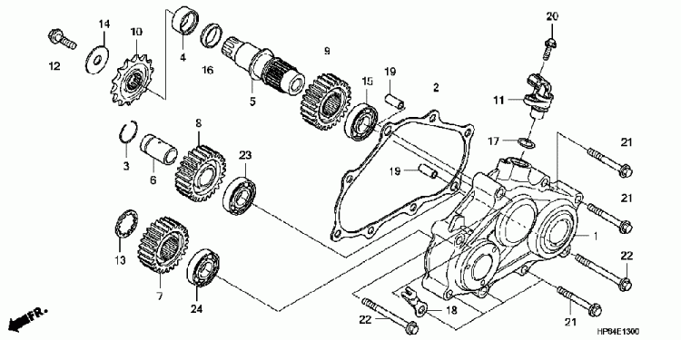

You can also look online for parts diagrams or exploded views.
Google your rig with the words :
"Parts fiche"
If you really cant find anything online, go to the dealer parts counter and tell them you want to buy parts from them, but you need to take it apart first to see whats broken, and ask them to print out the diagrams and or instructions. If they think they are going to make a sale, they will hook you up. Maybe its kind of sleazy to do this, but hey - the dealer is supposed to help out the customers out - not just try to bleed them dry.

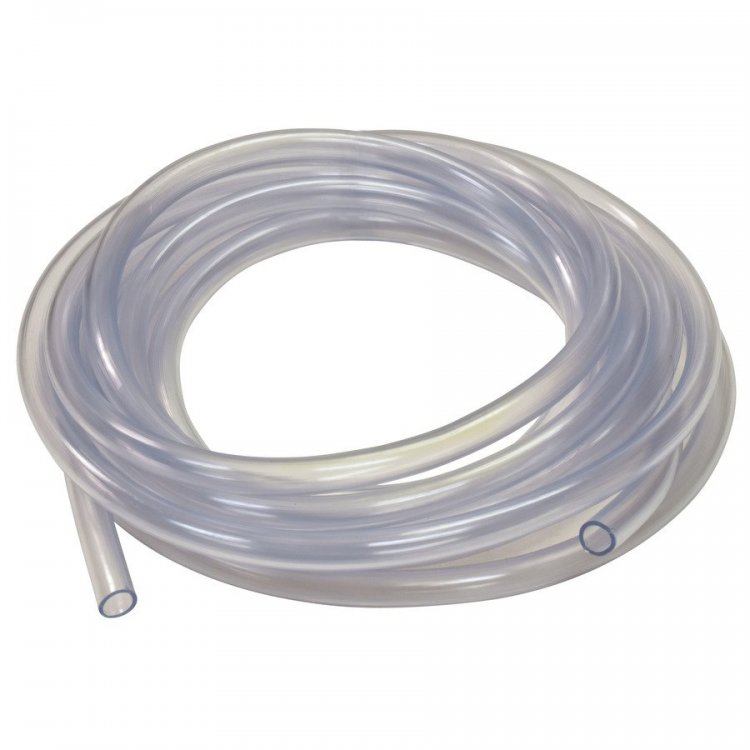

If you really get desperate, you could drill a hole in the lowest part of the HVAC box, and thread a fitting into it. Then connect a tube to that, and then run the tube through a small hole in the floor, near the firewall.
Drill 2 holes, 1 piece of tube, and a fitting. Problem solved.
