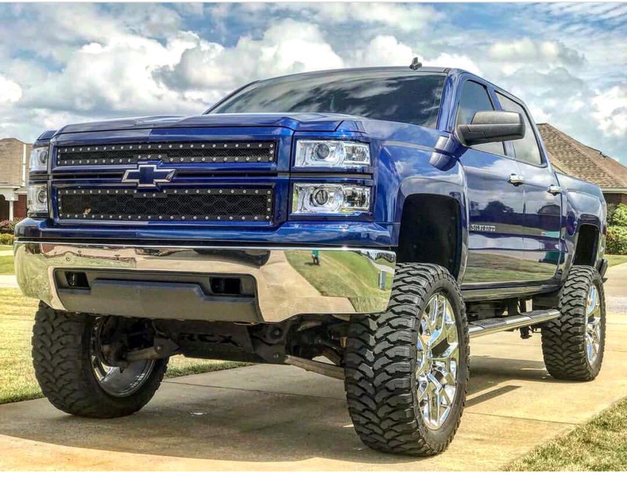

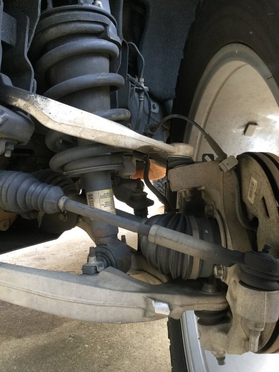

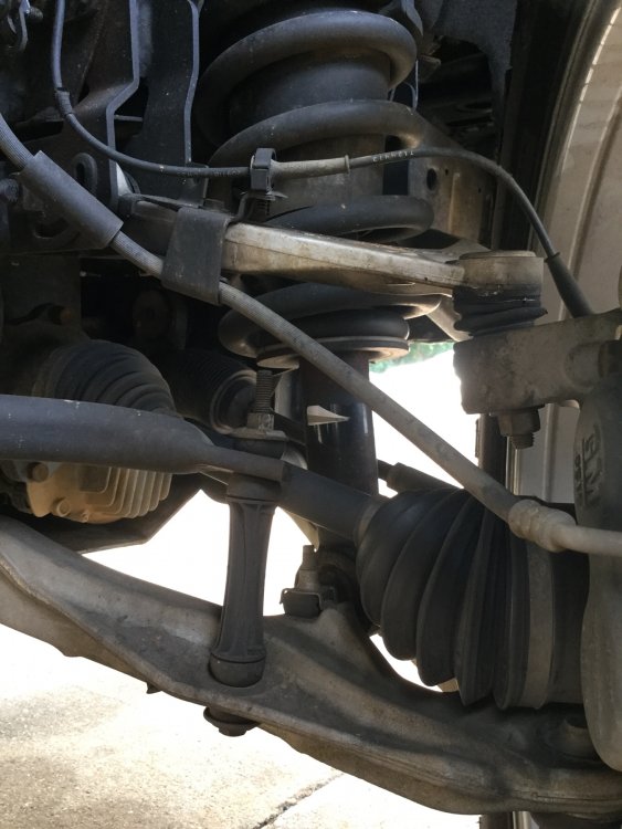

I have a 2014 Silverado 1500, with 7.5 RC Lift (it was on when I bought the truck) along with 3 inch BL (also on when bought) with 37x13.50R24 . Recently had I clunking/thumping noise when turning. I took it to the shop and they said my upper control arms were worn, and the springs were touching the control arms, they also said whoever put the lift on did a horrible job. Also need cam eccentrics, and cam guide pins. They also said repair top rack bolts to line up with old cam locks and my control arms were loose. So what I’m thinking is getting some better/extended upper control arms and new shocks while I’m at it. Can anyone point me in the right direction on what to purchase. Thanks

Lifted a buddies 18 Silverado same height with cognito arms. And the arms still hit the spring.
You might need to put a smaller lift on so the upper arm isnt at such an angle which will bring the arm away from the spring
those angles are terrible too... is that spring adjustable? is there a spacer in there?
