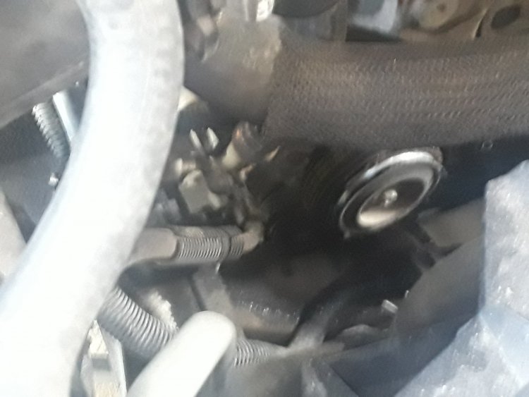

This is a pic from compressor now.
The clutch   It's not working.
it only seems that it activates and turns very slowly at certain times and then it stops and comes back, to do this several times.
Sounds like you've got a clutch issue. If it is simply not engaging fully then compressor will not turn at the proper speed. Clutch can be changed without changing compressor
I was thinking the same clutch issue..
