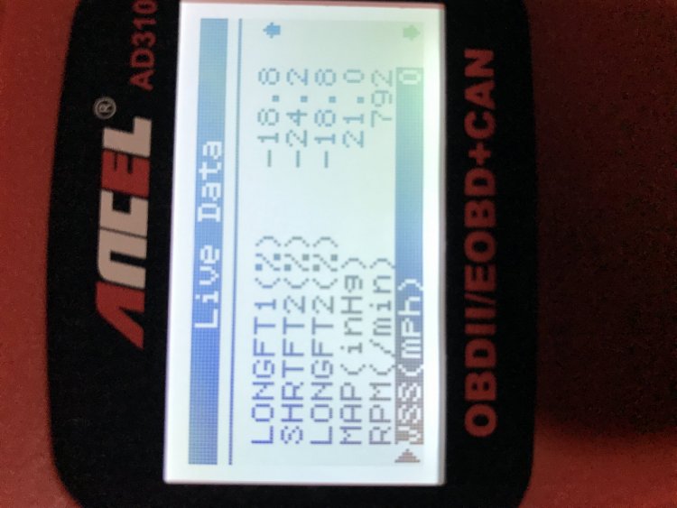

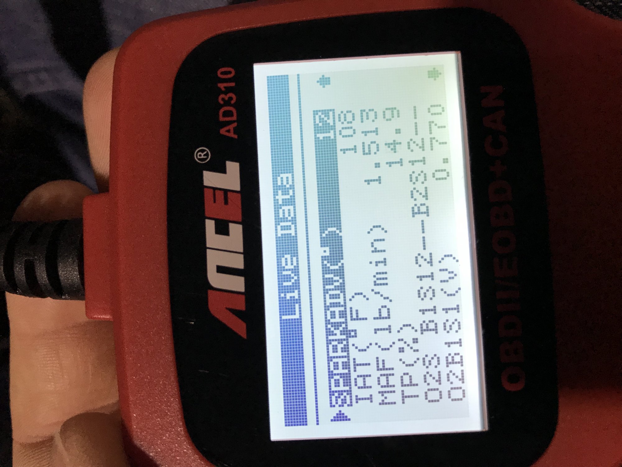

So I had a transmission guy look at my truck and drive it. He connected a Matco Tools Maximus 2.0 diagnostics tool. He confirmed that shifts were all good, and TCC was unlocking and locking as it should. He is pretty convinced that I have a bad MAF. My tuner said that it is throwing the code because the truck does not know how to idle properly with the new cam. So he suggests its fine to drive up to see him for the Wideband tune. What I need to figure out now is if I need a new MAF or if it really is a value that needs to change for the MAF to read properly. I have images of the live data values that I'll upload. I'd love some help deciphering it. IAT Values look good. IT's been hot here so I looked for low temps first off, but it normally reads about 99-110 degrees. It's been about 98 here lately. At idle MAF values show an actual value of around 1.513 lb/min. MAP values are 21.0 in/hg. Short range fuel trims and long range fuel trims show a high negative value of about -18 to -22 when warm. When cold a different story. I will say fuel economy has been horrible. About 8.8mpgs on the last tank of 200 miles. I averaged about 12-13 before the cam and tune. I haven't even been able to drive it hard so there's no excuse for the poor fuel economy except that I guess the tune is causing it to run extremely rich. UNLESS...I actually do have a bad MAF sensor causing it to overfuel like crazy. The guy tuning my vehicle has done thousands of these engines, and had personal experience with this exact cam several times. So much so that he sells this cam in his shop. No doubt in my mind he knows what he's doing. I'm trying to decide if I want to drop $80 on a new MAF or drive the truck up and get the tune finished before I do that.

You've got a pretty big vacuum leak, probably intake gaskets or something loose or forgotten when putting it back together.  Once that's fixed then consider the MAF and tuning.
