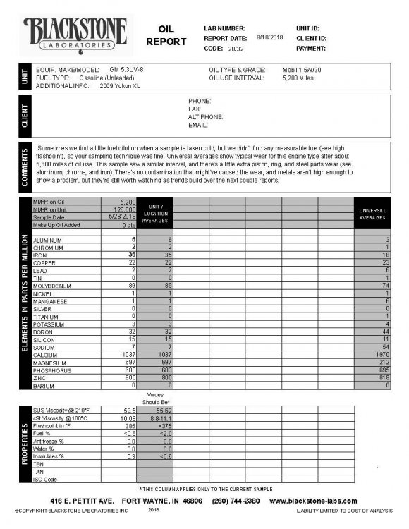

What Do You Think Of This Blackstone-Labs Report?
K&N Air Filter was replaced with OE High Capacity Paper Filter partway through oil change interval.  I neglected to tell Blackstone that at 111K the AFM system was rebuilt with new lifters and VOLM and related parts.
What do y'all think?  Engine is a 2009 5.3 aluminum block LC9.
