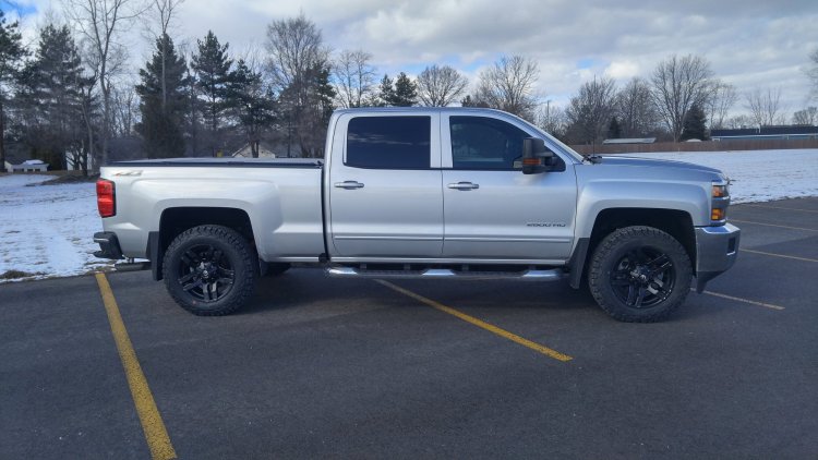

I tried them out on my 2015.
I also removed the big overload springs.
I liked the look and how easy it was to get in the back of the truck.
Ride was the same as stock. I didn't put anything really heavy in my truck or pull a heavy trailer at the time. (7k car trailer is all I towed with it like this.)
You have to modify the bed floor slightly for this to work.
There is a pinch weld seam you will need to fold over for clearance. No big deal. Just hit it with some paint and then some undercoating after you are done folding it over so it will not rust.
In the end I removed the drop shackles and lifted the front.
I needed to tow something a little heavier, so the overloads needed to go back in. And I wanted to add air bags to keep it from squatting. This meant it needed to be at stock height in the rear for them to work correctly do to there internal bump stops. So lifting the front was my only option to get it level again.
I still have the shackles if you are interested in them. They were on my truck for like 4k miles maybe? Just did not work for me.
