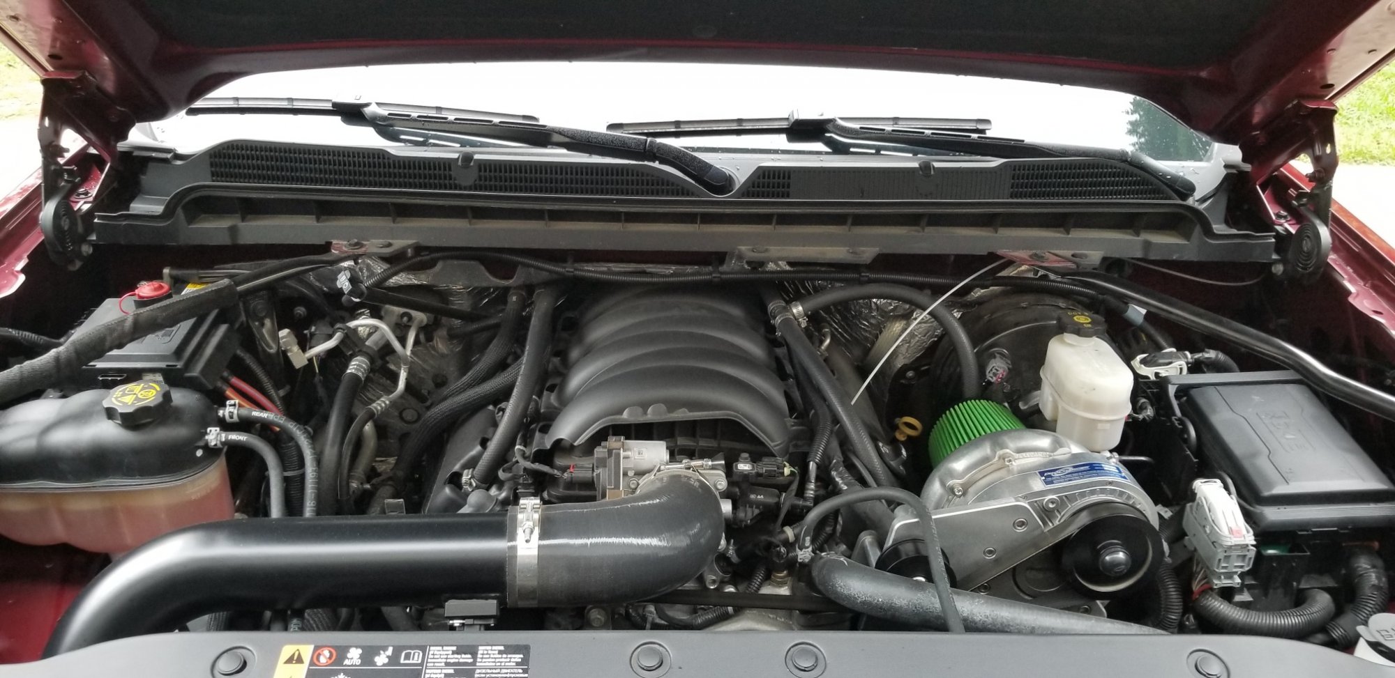

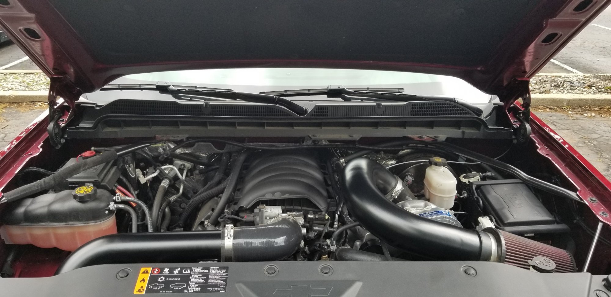

Well I had an issue being able to add oil to the motor with the intake on the ProCharger kit I got. Swapped it out and so far no major downfall to the change. The video says it all!
