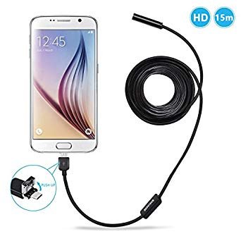

You might be able to use a "snake camera" to get up in there and see whats going on.
