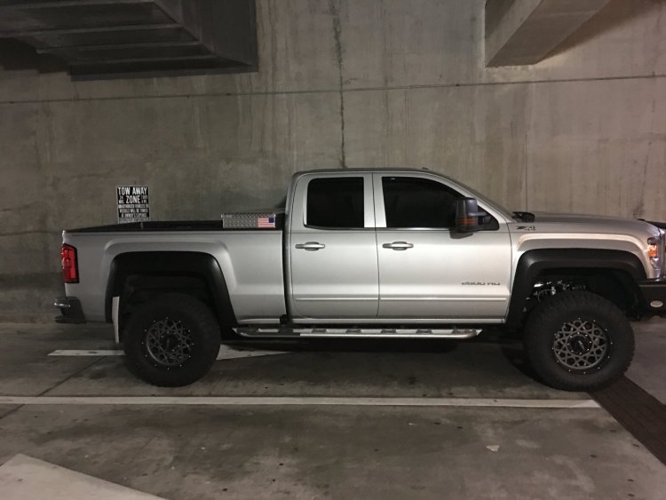

I cranked my stock keys to the max, but I still rubbed with my 285 75 18’s. I bought some SDT keys and shock extenders, diff drop, and some 5160’s Bilstein shocks. It sits right at level to fit the tires on the +12 offset wheels I have. I personally prefer a slight rake, so I’ll be putting in some air bags in the rear. I haul about a thousand pounds of tools in my box, and I like to throw the thousand pound 4 wheeler in the bed, doesn’t sag much, but that’s approaching max payload of 3,000 lbs with all the crap in my truck.
