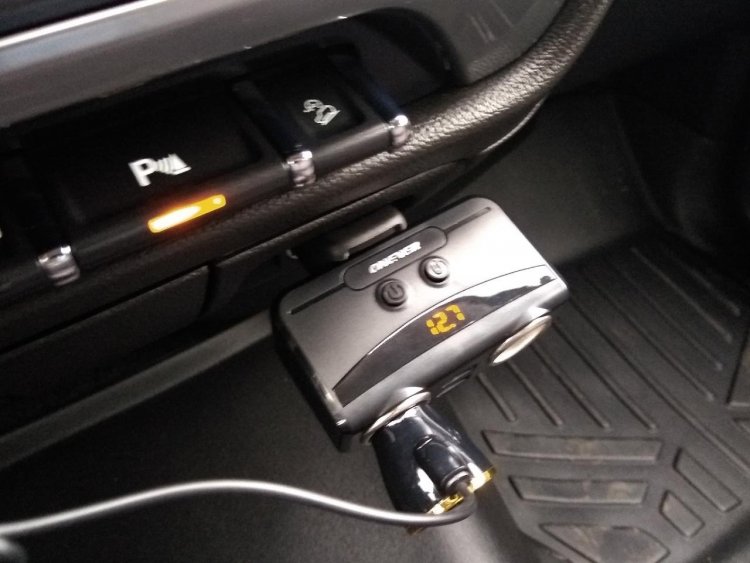

I have a 2014 1500 LTZ Z71.
Brand new Battery installed AGM style 850CCA.
My charging voltage swings wildy. When I start up I get the alternator to battery charging voltage of 14.3 to 15.2 Volts. As the truck warms it will begin to fluctuate, I can watch the volt meter drop to 12.7 Volts (battery voltage) it isnt dependant on Loads, headlights. accessories etc. also not dependant on engine RPMs. It will drop to 12.7V then if I turn the truck off and restart it will start out at 14.7 V then after 3-4 minutes begin to drop...then after awhile it may return to 14+/
Really weird. The comman thread is by re-starting the truck it always starts at 14.4+ then after waiting it begins to drop.
any ideas?
The truck has 60K miles and the original alternator I believe.
