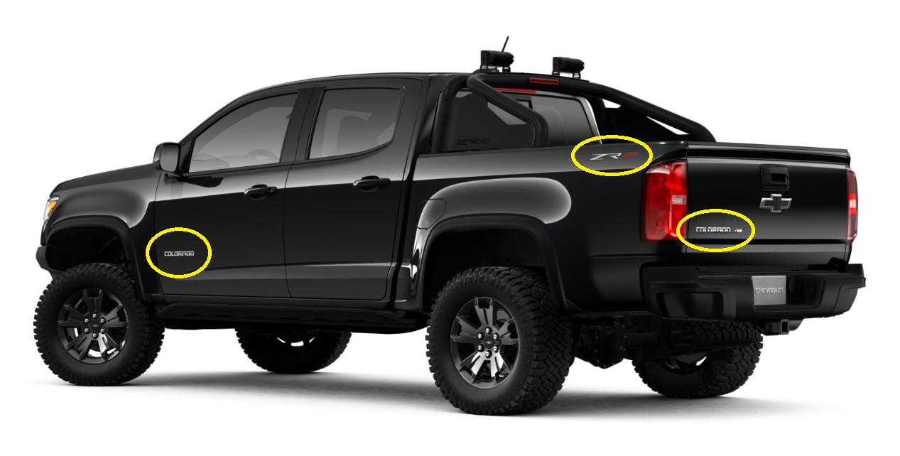

Anyone remove your Colorado emblems?
If so, any recommended tips for best practices?
ALSO:
How about removing the ZR2 decal too?
I imagine with a hair blow dryer and floss for the emblems, but not sure about the decal.
Thank you!
Check out the following links:
https://www.youtube.com/watch?v=HVdxXHb_KdY
https://www.youtube.com/watch?v=wsrH2kCyQ3w
But basically, I just used dental floss in a sawing motion to remove the emblems, then some 3M adhesive cleaner I got at Walmart to get the adhesive residue off the paint. I'd also suggest you use very soft cloth to remove residual adhesive, like a soft micro fiber, instead of a regular towel or paper towel, which can scratch surfaces.
I got the 3M remover because when I first used Goo Gone, it didn't work that well and I rubbed too hard and scratched the surface of the clear coat a little. The 3M stuff seemed to work better.
Afterward, I cleaned re-waxed the applicable panels, and they look good.
Sorry, didn't remove any decals yet, so can't comment on those.
