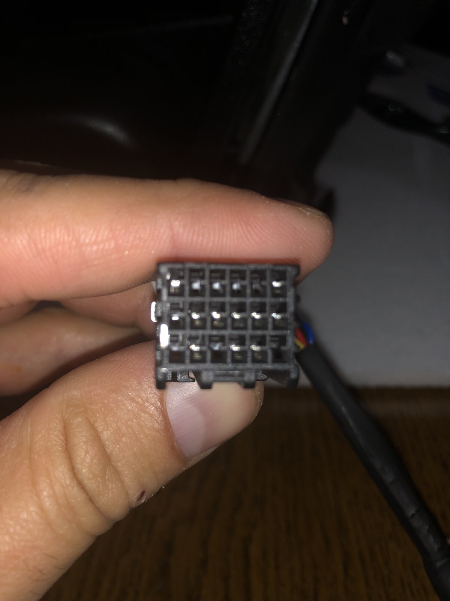

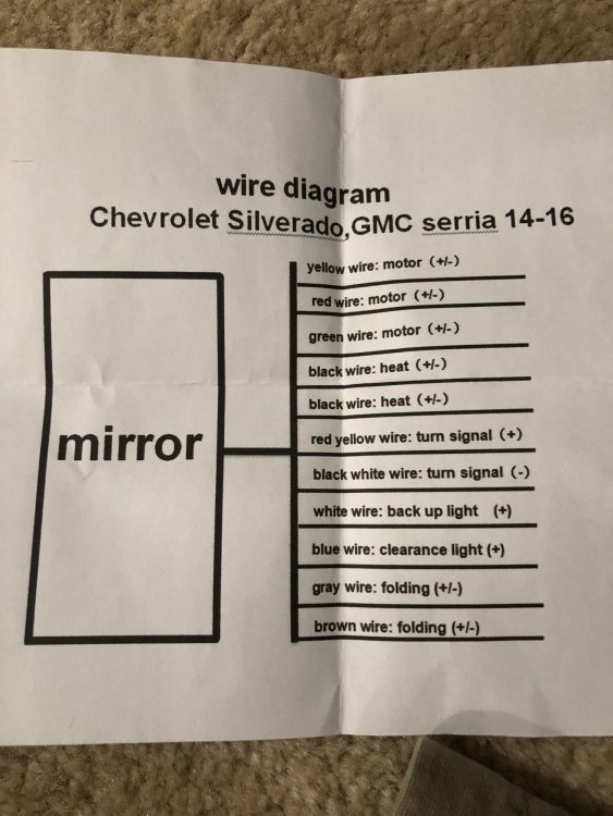

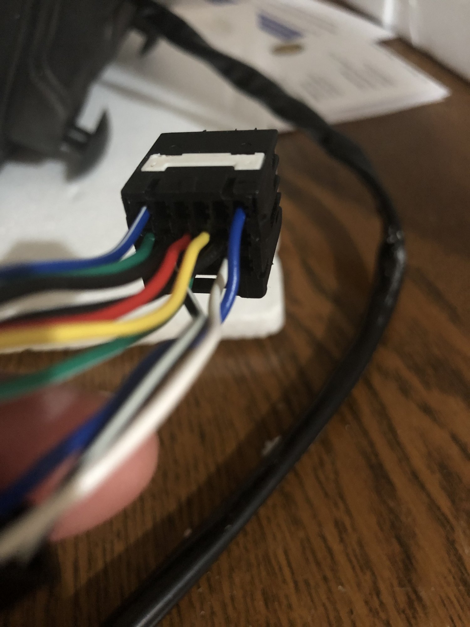

Purchased a set of tow mirrors that were suppose to be heated power fold power adjust and signal. Received the mirrors with no instructions and looks as if they didn’t include the wiring for the power fold from the looks of the diagram. Would I be able to purchase a simple wiring harness to allow these mirrors to power fold, or do I need to rerun them and continue looking for other options? (All wires accounted for besides the gray and brown that function the power folding option looks like) A36F6555-1CB6-4B53-A702-17F2E1A79C15.thumb.jpeg.ed32cb75e5ae3dc150c12a567b99fe7c.jpegF34F7B5A-C99D-4941-AED3-8D1AC7834546.thumb.jpeg.5110e2b716cd1da8eea3dfda2fff6c1e.jpeg6D20CA67-CF26-4363-8B1B-2629D7495241.thumb.jpeg.2ececa8283afb7a8d591e714c20796d3.jpeg
You’ll need different door harnesses to accommodate these mirrors.
Also, since you had DL3, you’ll lose key fob fold, reverse tilt, and memory since the new mirrors don’t support memory.
If you plug them as is, power fold, adjust, heat and turn signal will work. The amber light will behave like your old puddle lamp instead of a true running lamp. The cargo lamp won’t work at all.
With my custom PnP harnesses, all lighting will work correctly.
PnP harnesses are $285 shipped anywhere in the US. $100 is refunded if you send me your factory harnesses once complete with your upgrade.
Listen to pgamboa's advice and purchase his harness.  You will save yourself a lot of work and aggravation.  He will also provide you expert support via email if and when you encounter any problems.
