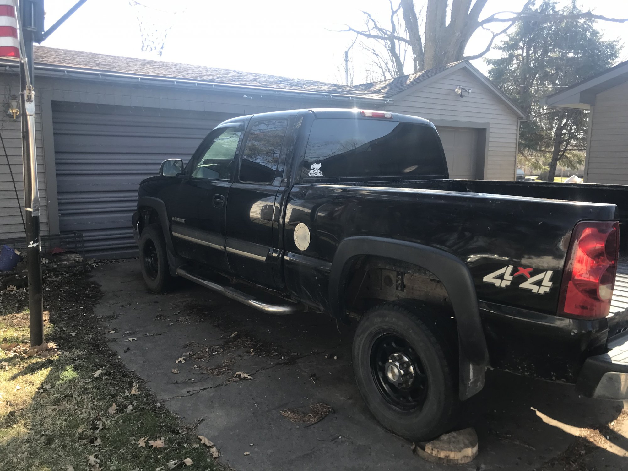

2003 2500HD Water Drains
Soaked passenger floorboard every time it rains. Where are all these drains located  to look at for clogging?
There isn't a drain for the floor.  You need find where the water is coming in.
If you have a sunroof, the drains for it can clog up and result in water coming into the cab, it can also come in around the doors, the windshield, if the door hinges if they have been replaced.
Check the fresh air intake between the hood and windshield. There is a drain on the outside edge. If clogged, water pools up and overflows into the air intake.
