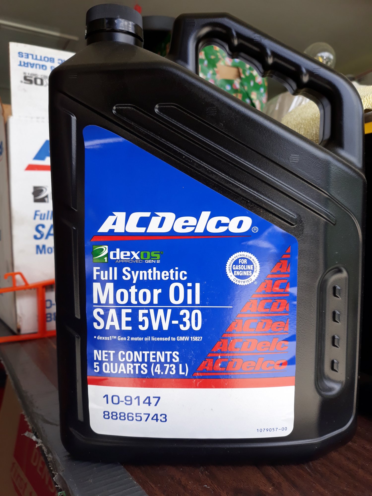

Been concerned with the performance of regular Mobil 1 in the 5.3 LC9.  Motor rattles on cold starts and she runs much better when 4K mile OCIs are followed versus 5K or 6K OCIs.
A few months ago I noticed that ACDelco was showing a new full synthetic engine oil when I ran my VIN on their page.  https://parts-catalog.acdelco.com/catalog/catalog_search.php
It was listed for 4WD vehicles, which around the time mine was built, was for 4x4 Yukon XLs and Suburbans as they got the aluminum block engines.  These engines see more expansion and contraction compared to iron block motors.  Would also apply to XFEs and others as well.
Anyhow, when the time was drawing nigh for the next oil change, I set out to purchase 2 OCIs worth and ran into a couple of large minimum quantity issues.  Finally found it 2 counties to the south and bought a case, three 5 quart bottles for $22 each.
I have NEVER seen the oil pressure this high across the board, ever.  It appears to be a solid 4 psi higher than before when at a hot idle and up around 50 psi on a cold start when before it was just about 40.  No more rattles on start up either.  Prior to purchase,  I compared specs and found that its viscosity numbers were higher than Mobil 1 regular full synthetic 5W30, about on par with the Group IV oils.  The SDS says the oil is made by Phillips 66 Laboratories.
If anyone runs it, please also let us know your experiences with it.  I'll be sending off a sample to Blackstone after the second oil change.
These are the part numbers:
1 Quart Bottles: 88865905 - 10-9234
5 Quart Bottles: 88865743 - 10-9147
Prior to this change, I had noticed lower oil pressure than normal and it was later determined to be caused by running the Mobil 1 M-212 long filter versus the PF63 and K&N HP2011.  Switching off the M1 for the K&N resulted in about a 3 psi increase in oil pressure at hot idle.  Now, with the AC Delco oil and the HP2011, hot idle oil pressure is about 29 psi (27-31).
