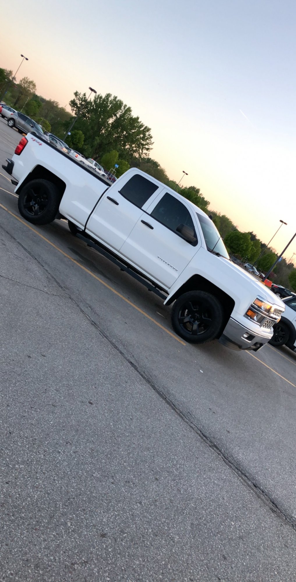

Hi guys. I have 14 Silverado double cab with 5.3. Just about to turn over 200k. Have been running E85 for a while now with no issues.
Yesterday I noticed my truck struggling a bit once I got on interstate after work. One could call this hesitation or studdering. Almost feels like a lot of shifting but it’s not just a change in rpm.  When I was on the pedal, light or a lot, the truck seemed like it was misfiring so I pulled off and looked into fluids a bit and everything was good there.
Went home after doing this and noticed that I had to be over 15mph to notice/feel the truck not seem like it was at full power when on the pedal.

On another note, I have a severe shake going on at 75 mph +. Just put a hair bigger tires on and level and it seemed to increase. Did 4wheel alignment and that didn’t help. This was prevalent on old tires 18 and new tires 20.
I noticed that the drive shaft has been under coated (supposed to do that?)and I am seeing some rust specs that Are starting to form. Could this be the culprit?
