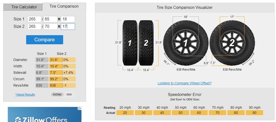

They're both nearly the same.
The 17" is 31.61" in diameter, while the 18" is 31.56" in diameter - or .14% smaller.
Below 1% is acceptable, and you're well within that range.
Both exactly the same size.  I have the 265/65/18 as stock on my Z71.  I don't think you'll have any issues at all with those.
