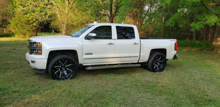

Hey guys what is the largest tires that will fit on a Silverado 1500 high country with stock suspension and 20in factory wheels. Without trimming. It’s time for new tires and would like to go up a little if possible. Currently they are 275/55r20.
I have a 2015 high country I put a level kit on mine to clear 33 inch tires and still had a little scrubbing when making a hard turn.
