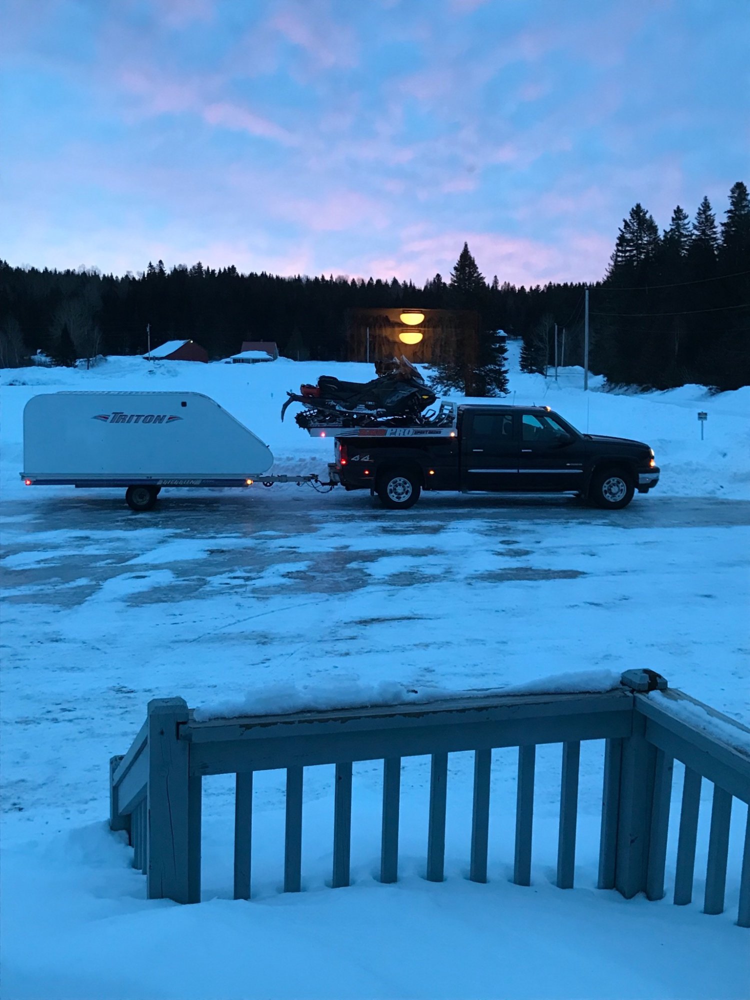

Have 05 1500HD Quadrasteer which I love! Has 6.0 with 4 speed, range when towing is just over 200 miles. So I would like to switch a late 6.2 with 8 speed drivetrain which is very expensive, or a late 6.0 VVT with 8 speed just not sure if being cheap at the point that I am changing drivetrain I should just do 6.2. My questions are has anyone done this type of change as searches have not come up with much. Thanks for any information!
