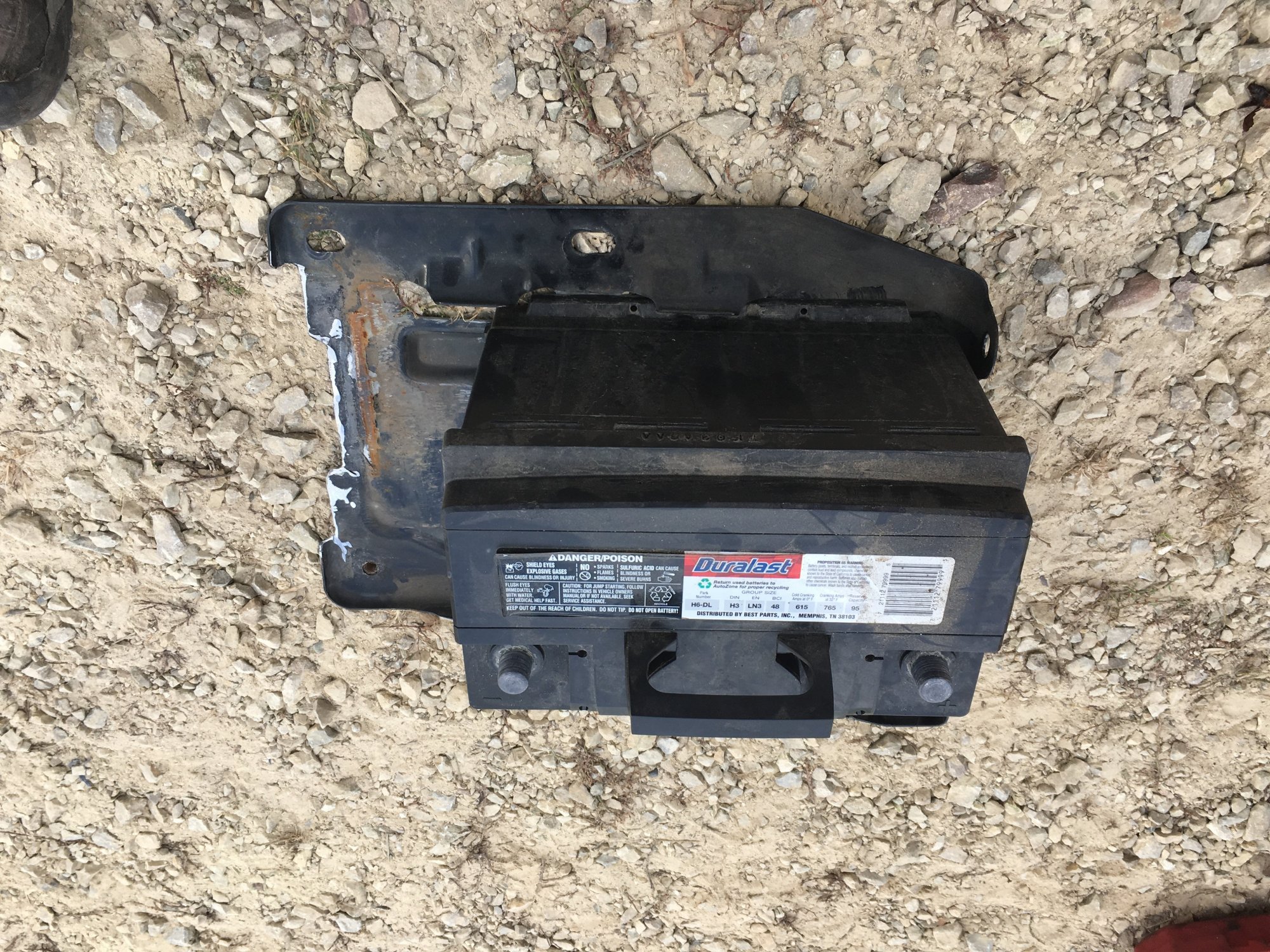

First picture shows the modified tray. It's modified both top and bottom.

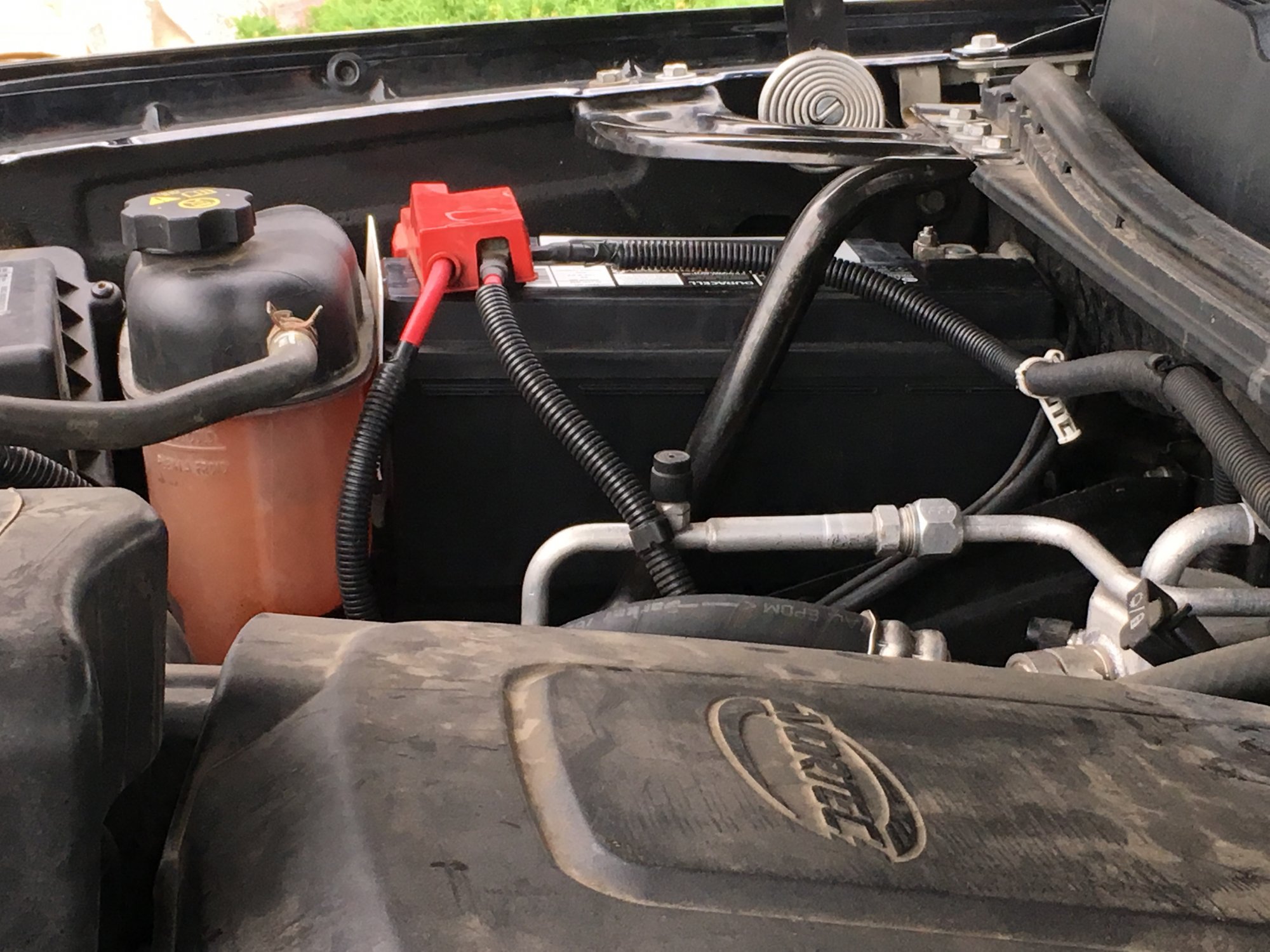

Second picture shows how much extra room is on the tray now.

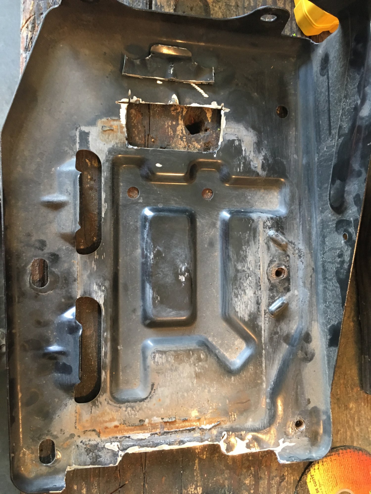

Third picture self explanatory.

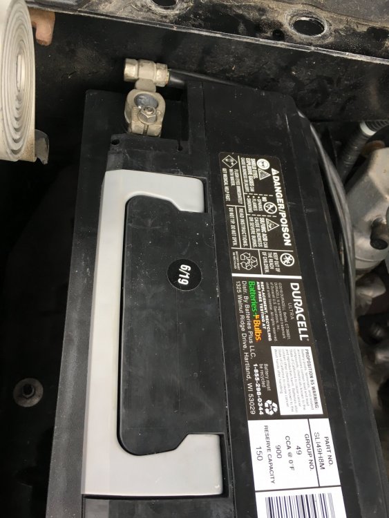

Fourth picture shows the problem I ran into. The negative battery cable wants to run between the battery and the firewall which moves the whole battery over almost a half inch.

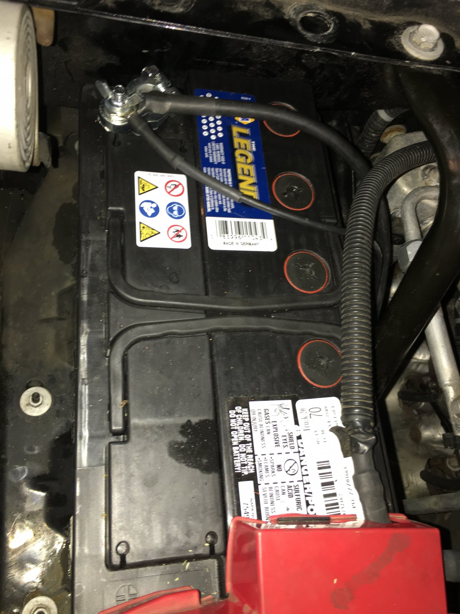

Fifth picture shows how tight it is for space. I'm going to put a new end on my negative battery cable and route the cable over the top of the battery so I can slide the battery away from the coolant overflow tank.

Finally got the ground terminal changed and everything fits a little better now. Wires where 2guage and 10-12? gauge. I used a hydraulic crimper I bought off amazon, I wasn’t comfortable using my hammer crimper for this critical job.
Getting that marine style terminal on and tightened up was kind of a pain would have been easier if I put it on when the battery was outside the vehicle.
Also some may notice I changed the Batteries Plus battery for a Napa battery. You can read about that here if you like.

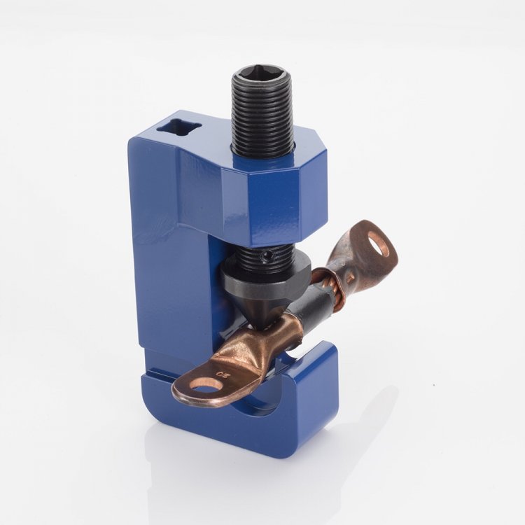

This is the crimper that I use for large lugs. Put it in a vise and hit it with an impact. Easy and does a great job. Then I heat the lugs with a torch and fill the inside of the lug with solder. Then heat shrink over the connection.
That looks better than the hammer crimper I have, the way it’s got three points to smash into the terminal. The one I have just kinda smashes everything into a V shape.
