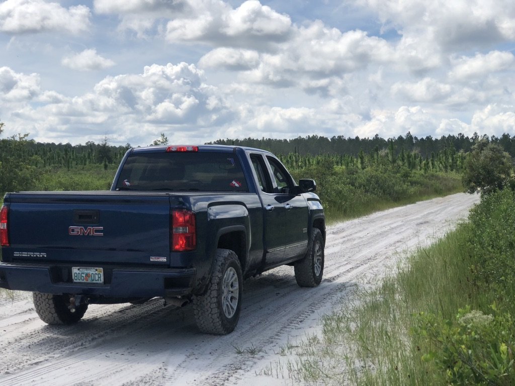

25k miles ago I got 275/70R18 KO2s on the stock wheels and I have also been happy with those, but they did hurt my mileage, especially around town. My truck has 3.08 gears though and they don't help.

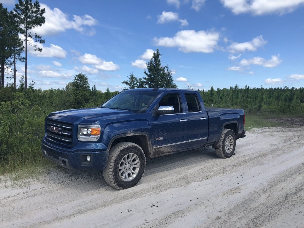

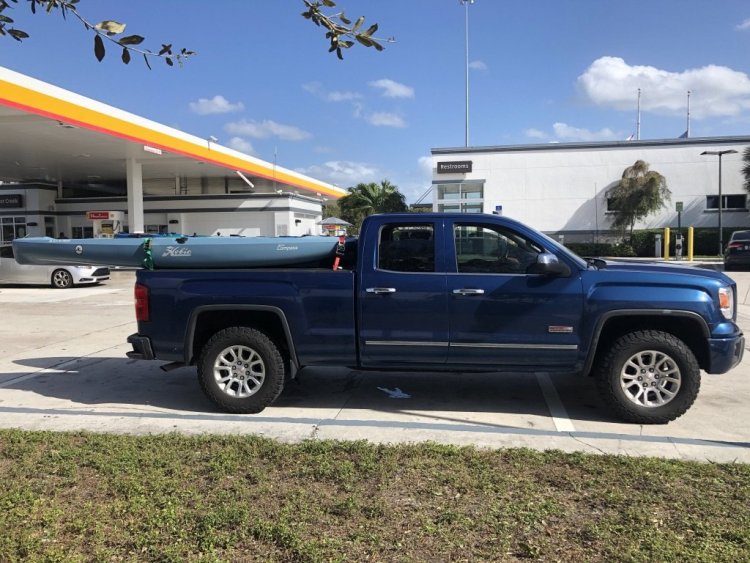

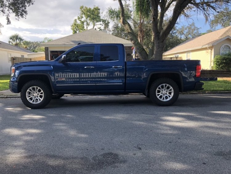

I'm putting some pictures in this post so you can get an idea of the what the 3rd setting looks like with the stock rear block and 33 inch tires.
Right after tire install:
UNADJUSTEDNONRAW_thumb_7f8.thumb.jpg.70a2a5c8ed2c11bab42eef2e5e49ce78.jpgUNADJUSTEDNONRAW_thumb_808.thumb.jpg.079cbc0face037baf5afa635ff806dc7.jpg
This is with around 1100lbs of scrap wood in the bed:
This is probably 500lbs in the bed:

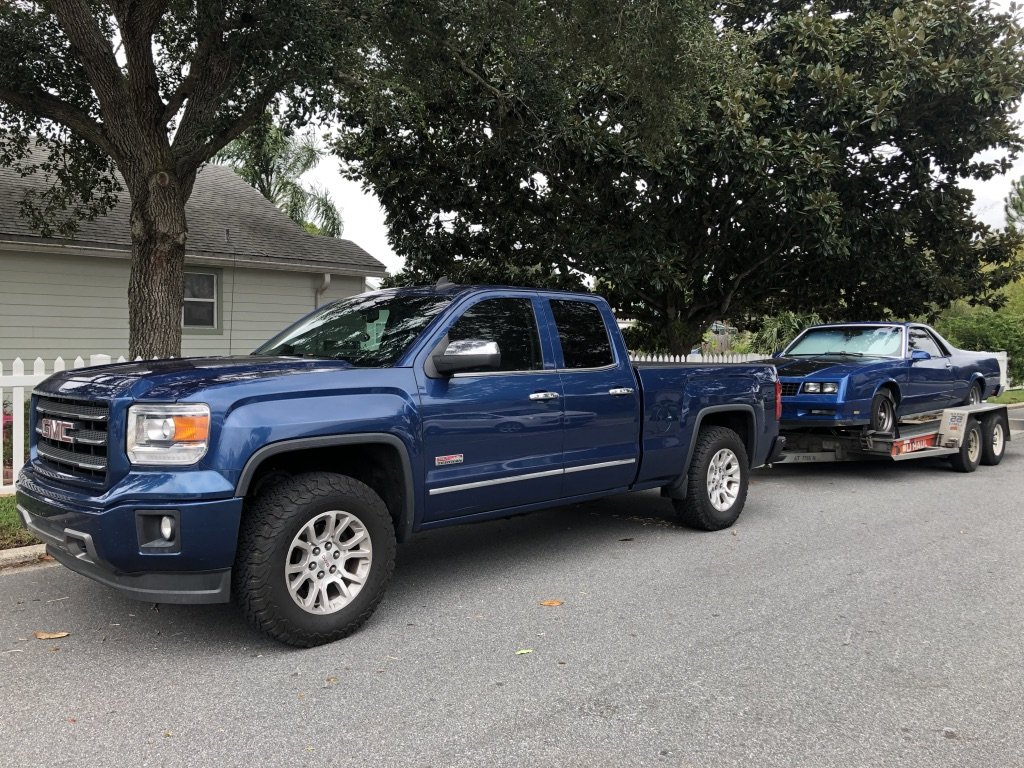

This is towing the El Camino, about 4500lbs but the weight is biased forward on the trailer:
UNADJUSTEDNONRAW_thumb_fa5.thumb.jpg.bf48e1f6ec9aee33475959560cc2ef9e.jpgUNADJUSTEDNONRAW_thumb_f9f.thumb.jpg.c204da4b97e7b65f5fc99ef4915a39a0.jpg
So far the 5100s and tires are the only changes I've made to the suspension. When the ball joints wear out I'm planning on getting new arms, and at that point I'll either up the lift to the 4th setting or get some 6112s and install them at the 4th setting (both are supposedly the same at 1.85" of lift). When I do that I'll lift the rear also, but I have the blocks sitting around so I might do the rear first to see how I like it. With the shocks on the top setting and the rear blocks installed, I should see around 1/2 inch more rake. Right now I have 1.5 inches of rake with the bed empty. Measuring from the center of the hubs to the top of the wheel arch I'm at 22.25" up front and 23.75" in the back.

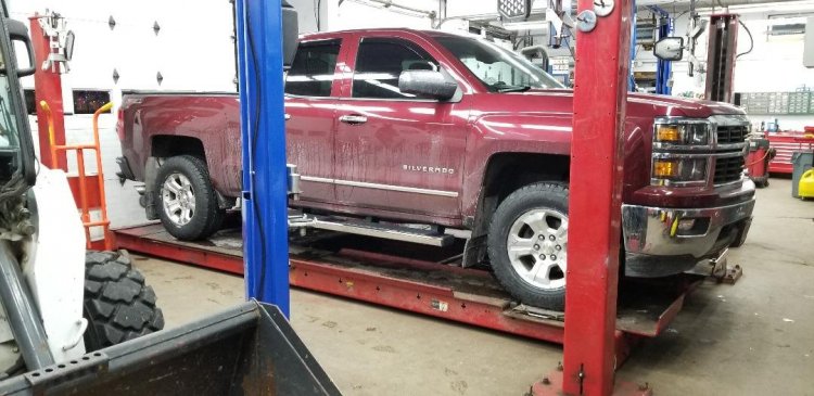

I did the install up at my shop this past weekend.  Everything went smooth, these struts are VERY easy to get out of the truck... just the 3 upper nuts and 2 lower bolts and it's out, didn't even need to loosen the end links.  Going back in I needed a little more wiggle room, so I removed the end links, still VERY very easy though.
I didn't take really any pictures during the actually install because I was rushing to get everything done before evening plans (I was also doing tires, rear brakes, new side steps and some other little things)
Install notes:
-I re-used the OE strut shaft nuts to avoid the Bilstein-bump.  The OE nut is definitely better quality than the supplied nut with the strut.  Ideally I would have gotten NEW OE nuts to use seeing you're technically not supposed to be re-use those oval lock nuts.  But, I didn't have new OE nuts, and the old ones still seemed like a better option than the supplied nuts.
-I went with the highest setting (4th notch) and got 2", but that was right after coming off the lift, so there should be some settling.  Currently I have about 1/2" to 5/8" of rake.
-I also re-used OE clip nuts, because again they seemed like better quality than the supplied nuts.
-Alignment was not very far off after install.  Camber and Caster were dead on, Toe was about 0.3* off on both sides.

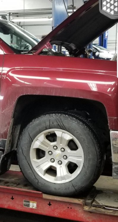

Before pictures:

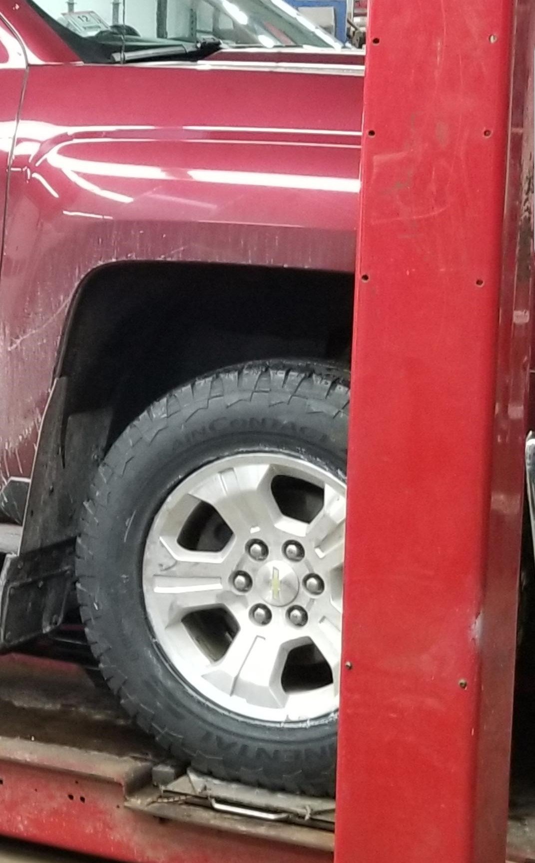

After:
