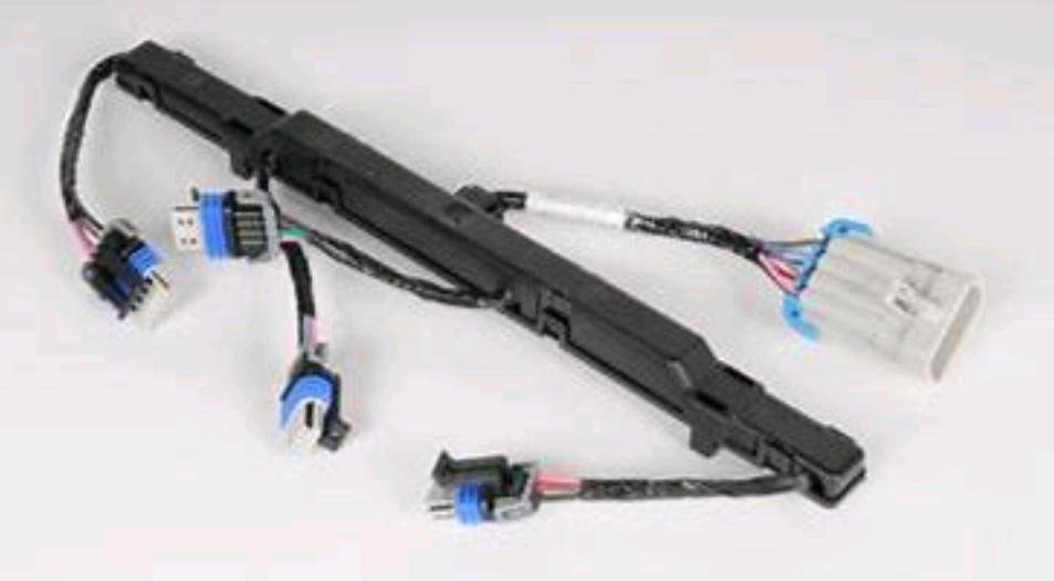

this harness going to the coils  check it / swap it and see if misfire follows

Going to grab hp tuners and run some diagnostic on weekend last remember the only ode was p0300 but now went to look at it and basically not firing passenger side at all atm. Never though of actually checking that harness it's self. I am about to cut cat off and see if it's plug or not
