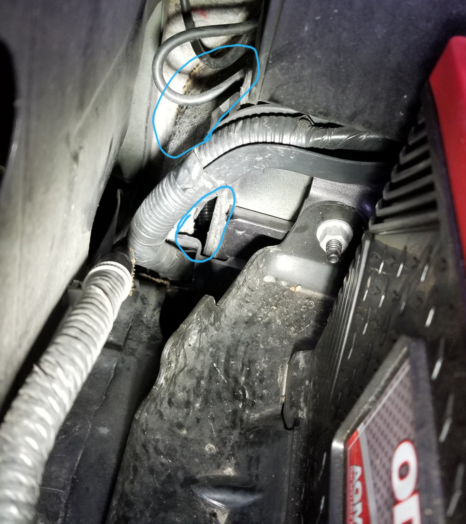

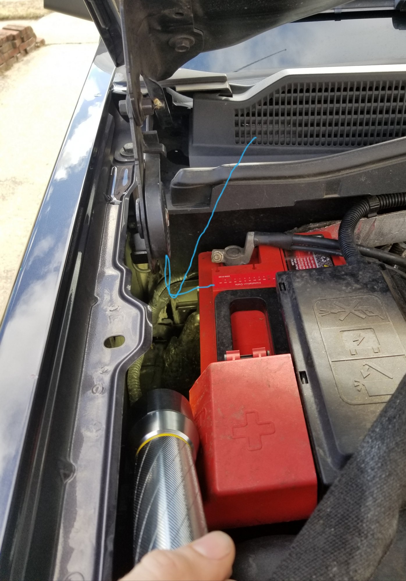

I would like to know, otherthan a manifold leak or leak between the manifold and cats (which is what I'm going to check next), what else IT COULD BE??? I have sent some oil out to Blackstone to check for gas or coolant, my results are still pending. I also have changed the cabin air filter and didnt notice anything wrong. I plead ignorance on knowing where exactly the vehicle is pulling the cabin air in from however??? Does it come from the passenger side just below the wipers? Is there anything there I should be checking? I did notice a gap, on the passenger side, low, and behind the battery, between the side wall and what looks like firewall material... I added a picture... any thoughts would be appreciated... Thank you, Chris
It pulls from the grate at the top of your arrow. If you're smelling it coming from the vents its coming in there.
