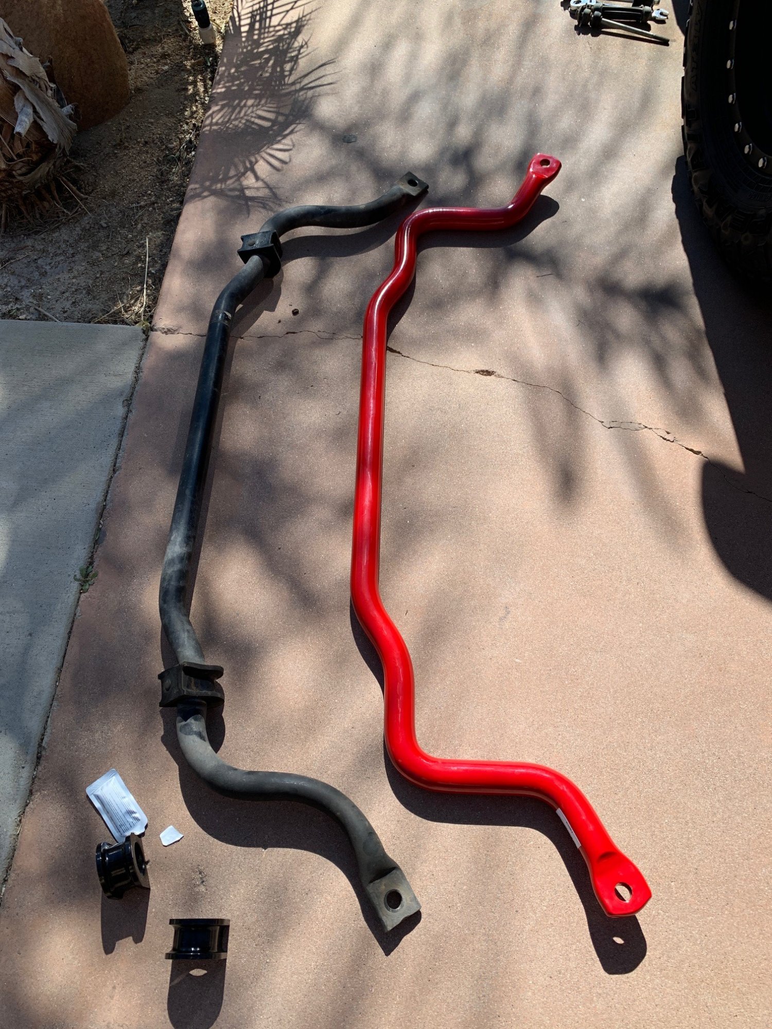

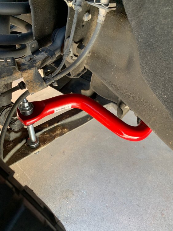

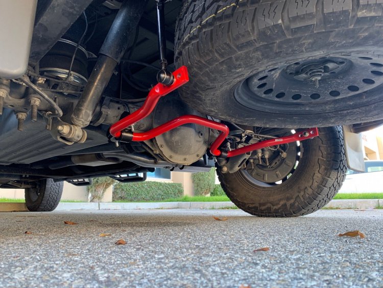

Installed a rear sway bar ?  The red looks sooooo good under the truck.  Now I am not jealous of the TRD sway bars on the Tundras!!
Feels really solid just driving around normal. I have it in the middle setting.  Im going to purchase the front sway bar to match and the whole truck should feel solid even being slightly lifted ?
Clears my full size 33" spare no problem. Air lift bags aren't in the way or anything. Everything fits great.  The end-links are adjustable as well for higher lifted trucks, but these will only go up just a few MM more.

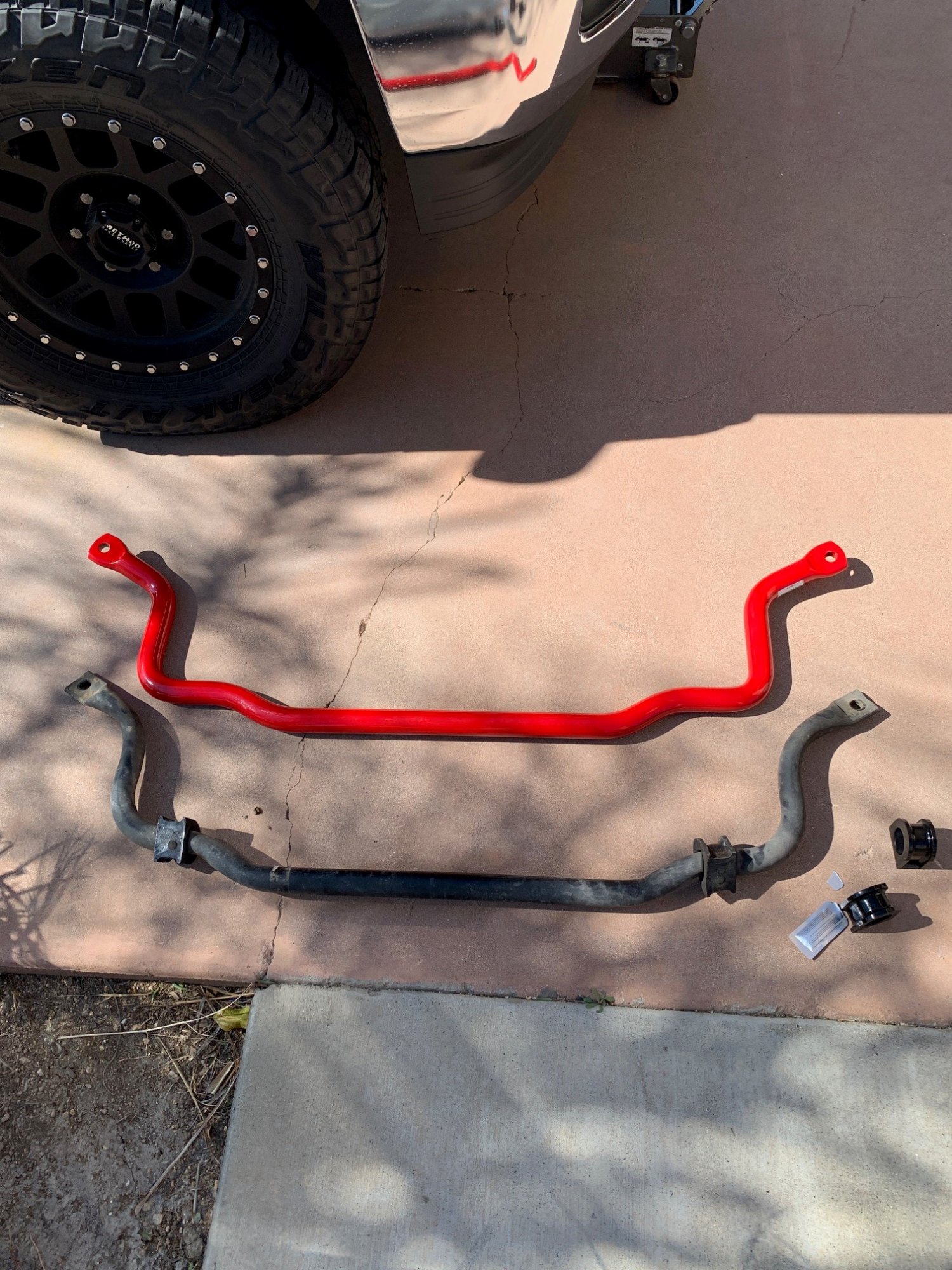

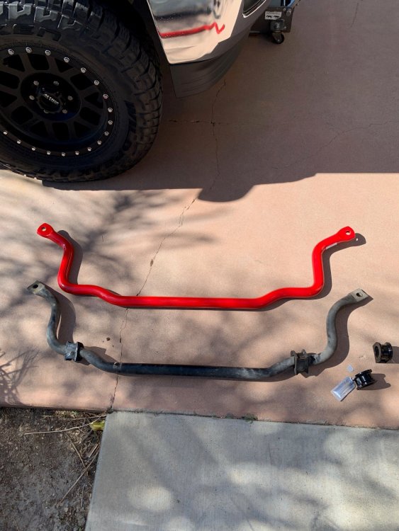

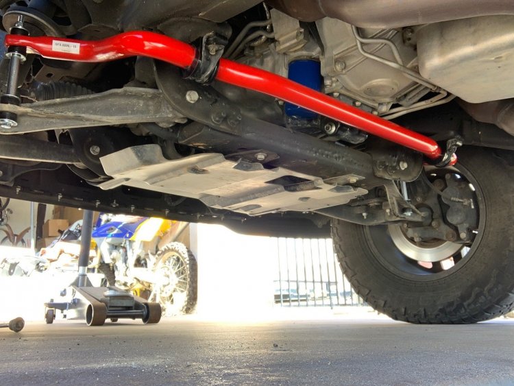

Its been good! I actually just installed the front bar as well this saturday. That part is on the website, but not listed for a silverado. I confirmed it fits, but I did have to use some different endlinks and had to modify those. Front bar is a 38mm solid steel bar, Oem is 36mm tubular.
The rear bar should be listed hopefully soon.
