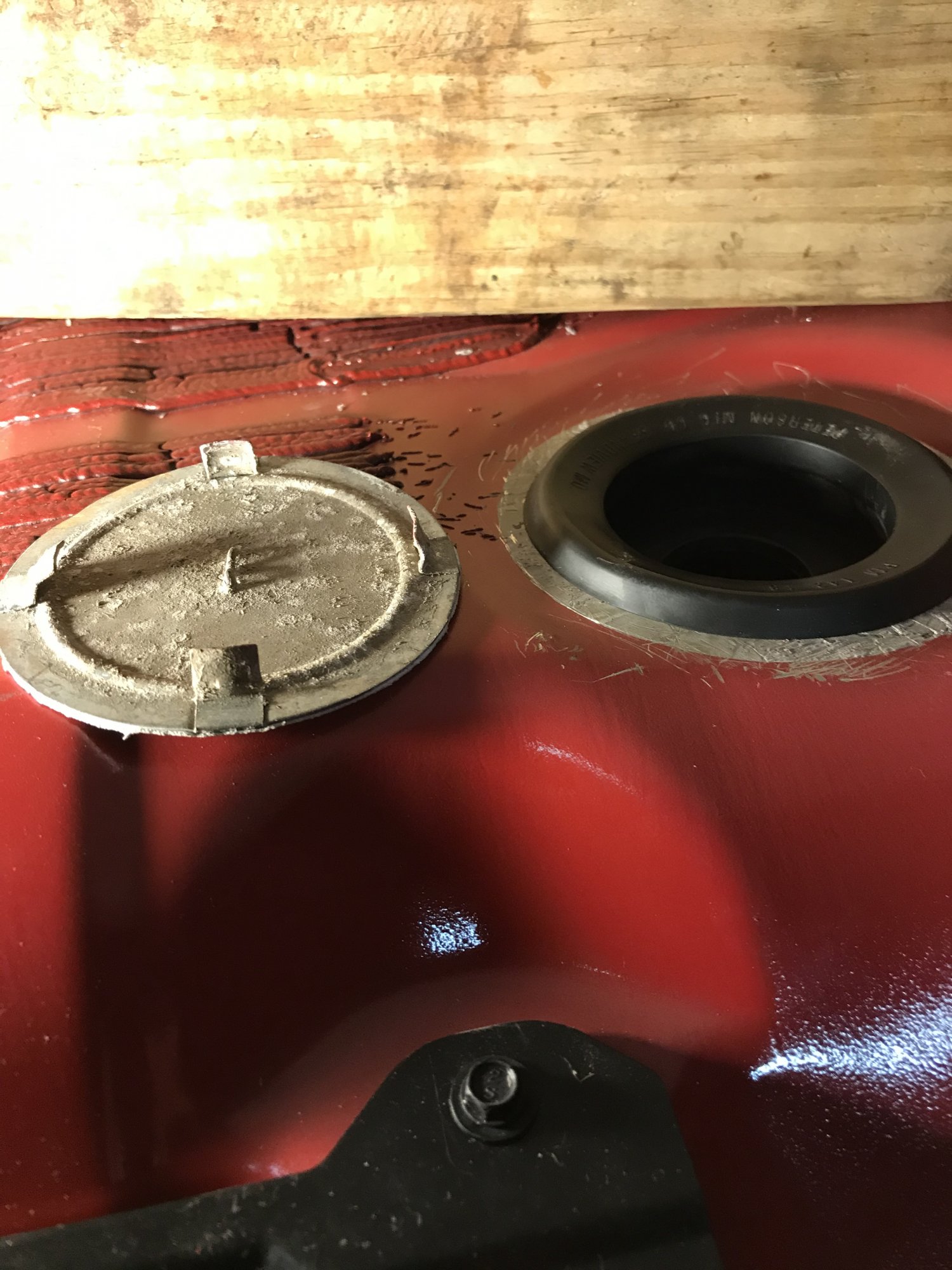

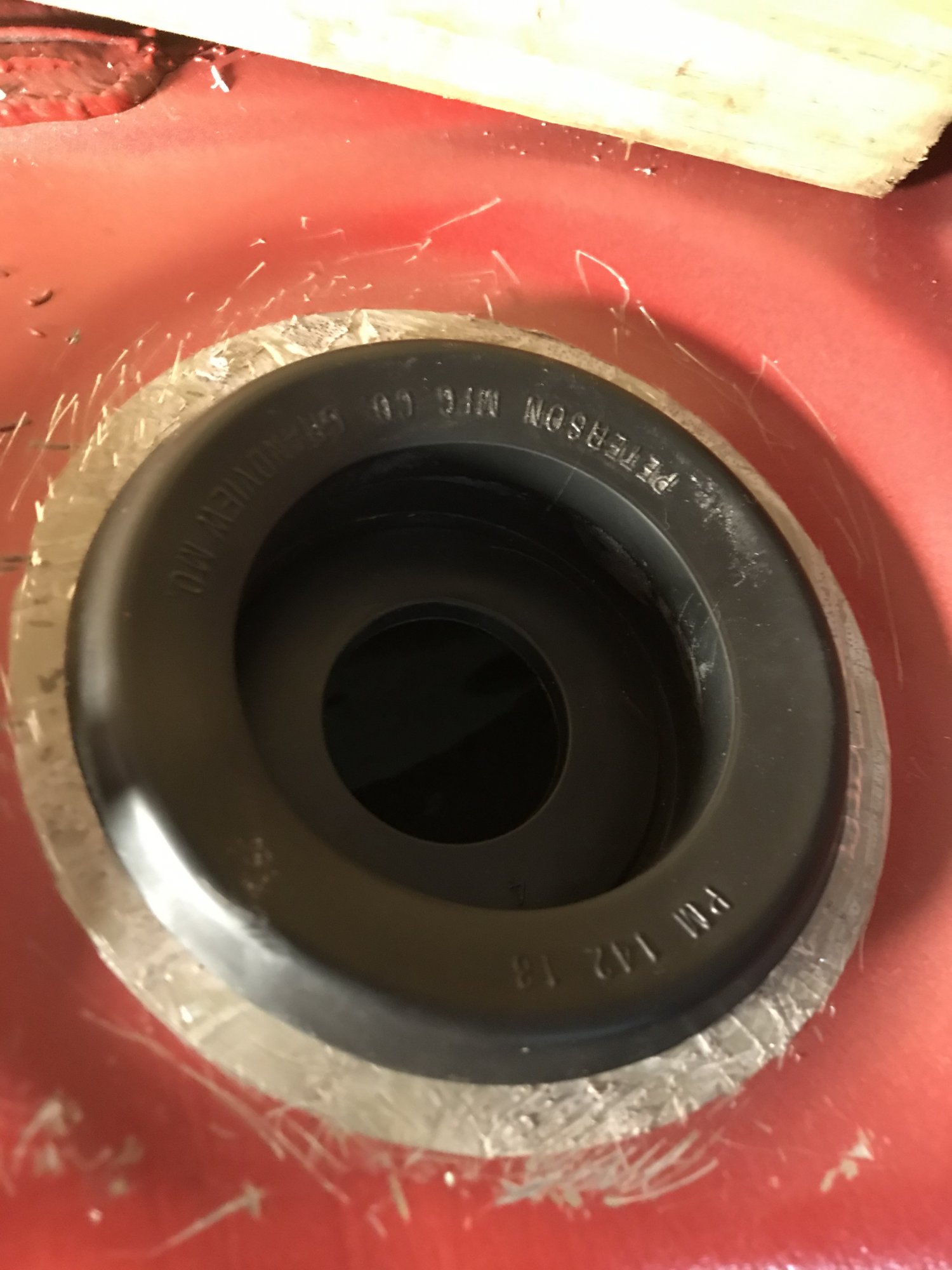

Anyone looking to send accessories wiring into the cab, there is a neat option using a soft plug in the back seat floor near the sill. Once you remove the plug, reinstall a closed back trailer light grommet in the hole. You now have reduced the large hole down to whatever you need, and can fill the well with sealer when your done.

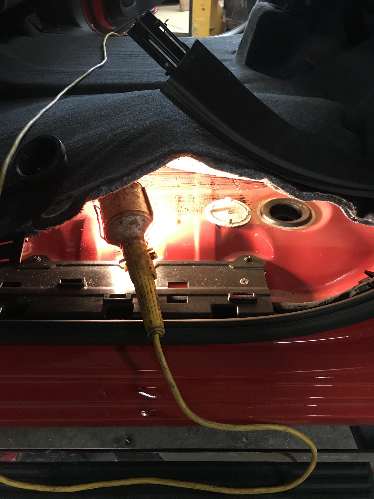

Remove the sill plastic trim, lift the carpet, slide a 2x4 in to hold it up and use a window razor scraper on a handle to cut the sealer and pry out with a flat blade.
This is close to the wire chase that will allow to fish wire to the front towards the upfitter switch etc.
