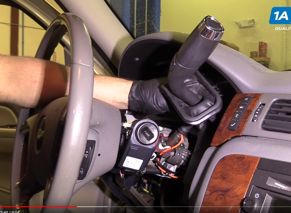

Hi,
i crawled underneath the truck and looks like the cable seems to be functioning as it should, i took the cover of the column and inspected the column shifter. it appears to me that the "yellow" spring ( please see pic) has collapsed/broke as the shifter kinda dangles when you pull on it. is this spring replaceable? i am pretty sure this is the culprit as this spring compresses the most when shifting in and out of R
PS this is not my vehicle in pic - its from a you tube video lol
thanks
Wow those always break on 99-06 trucks haven’t seen them on 07+.
Anyways you can technically replace that spring but it’s a pain and there’s a chance of stretching the shift interlock cable. I always replace the shift control assembly.
Good find! Never seen the newer ones broken it’s always the shift cable.
well from what i can tell it is the spring. when the shift lever is in P and i pull on the lever to put it into a gear it is very sloppy/loose. Most noticeable when in P as it kind of just flings forward and back with a light touch with a finger. it dosn't seem to be binding now when i try to put it in R from P or R from N however the sloppiness started soon after the binding went away.
anything else i can look for? the spring doesn't seem broken but i cant tell for sure. do you have a pic of a shift control assembly just so i can confirm what we are exactly talking about? seems like the scrap yards only sell the columns as a whole unit only.
can i change this control assembly with out removing the whole column? if so maybe i can just order a new part Vs replacing the whole column
thanks
