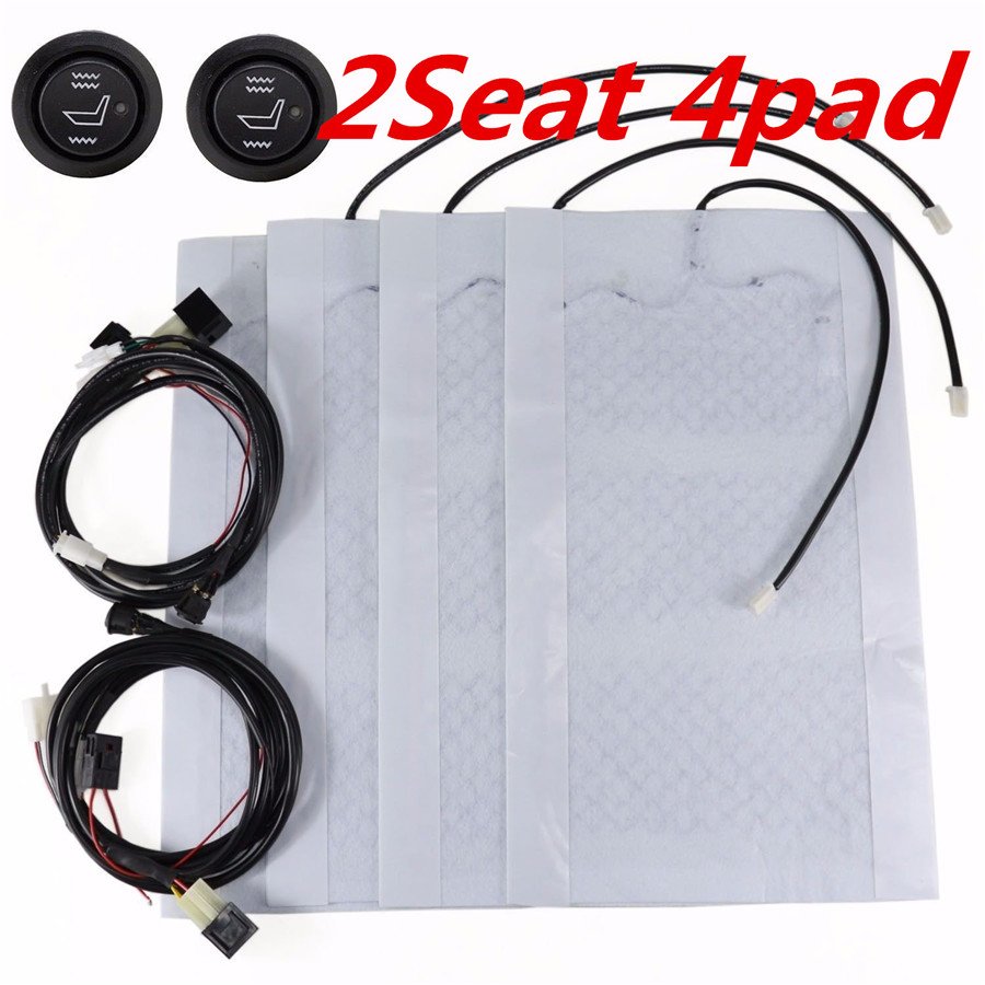

Mr Vee Posted February 9, 2020 Author Posted February 9, 2020 Found these on ebay so I think it was just a 3rd party seat warmer kit. Now that gives me a little better idea for where to look. Will report back what I find
Mr Vee Posted February 10, 2020 Author Posted February 10, 2020 It was the red wire running to the dash. I think it wore from seat movement. Found the other end under the console and spliced them back together. All good now
