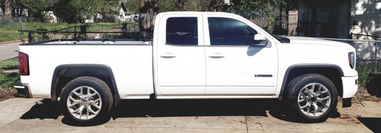

This is on a 2018 gmc Sierra. I have the 2" drop shackles and removed the blocks.  So total drop is around 3" in the rear and the truck still isn't quite level or low enough for me. I want to drop the rear 1" more which I think will put the truck where I want it. I have searched all over for the answer to my question but cant get a clear answer. Is my only option to lower it that last inch to flip the axles? Any suggestions?
