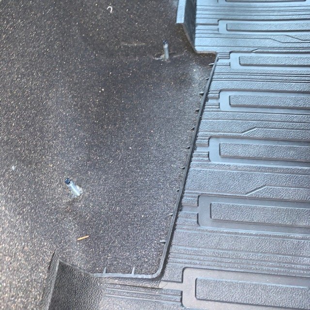

1. Lift up the back seats. If you don't have the storage box underneath you won't have to do any cutting. You can just put the liners in. In my install I wanted to leave as much of the liner as I could and still install the storage box. The drawback is if I ever want to take them out for cleaning I will need to remove the storage box.

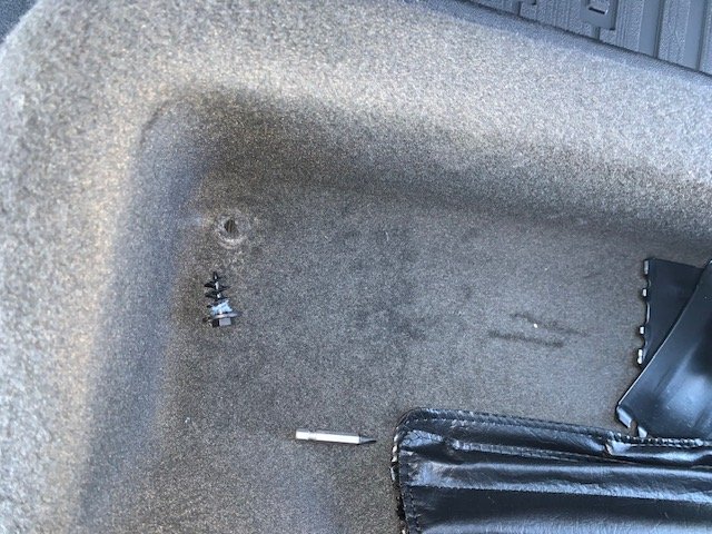

2. Remove the jack, jack holder, the bag the holds the lug nut wrench and one screw holding down the drivers side corner of the storage box. It's a big torx screw but I removed it fine just using a flat blade screwdriver.
3. Lift out the storage box and install the liners.
4. The drivers side will not require any cutting. In the picture above, you can see how they designed it to go around the jack mounting bracket. When you place the storage box back in place, the lip will keep the box from being flush with the liner.

Here is the drivers side. I decided not to put a hole in the liner to reinstall the screw. It sits pretty flat and the lug jack bag will keep the box in place I believe.

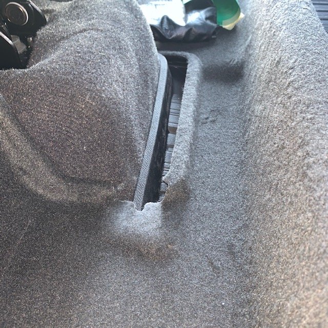

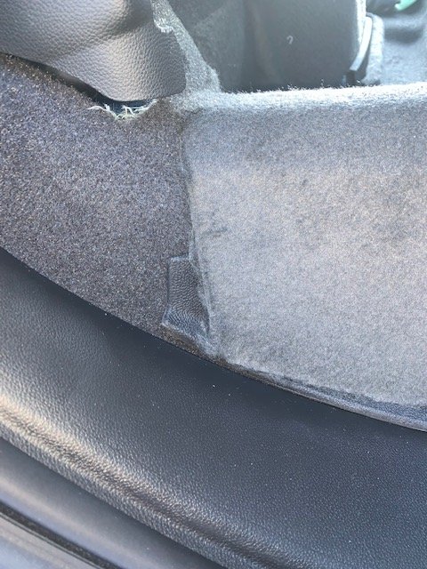

Here is the part I did not see until I looked at the pictures. On the passenger side it appears the carpet got pushed down and there is now a gap between the trim and carpet. Will see what additional trimming I may need to do so it sits correctly. Maybe I just tightened the jack mounting plate more than I needed to.
