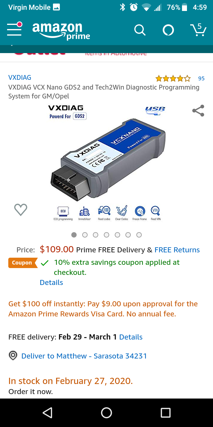

If you want to use a laptop, you can get a VXDIAG NANO to interface with your computer which will have to run Tech2Win to talk to your truck.

Found this. Looks like it includes both item(s) you mentioned. Buying soon.
Cool, let me know how it works out.
