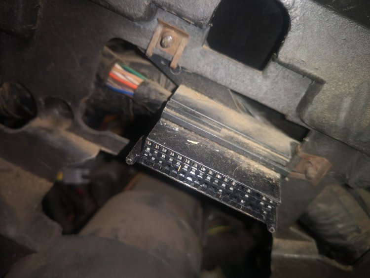

Just wondering if anyone has a detailed diagram or description of how to remove the dash from a 93 Jimmy SLE. I only have the digital cluster left to remove however there are three screws that attach it. I am unable to get at the screws with a wrench. Any help would be appreciated.
