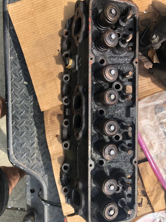

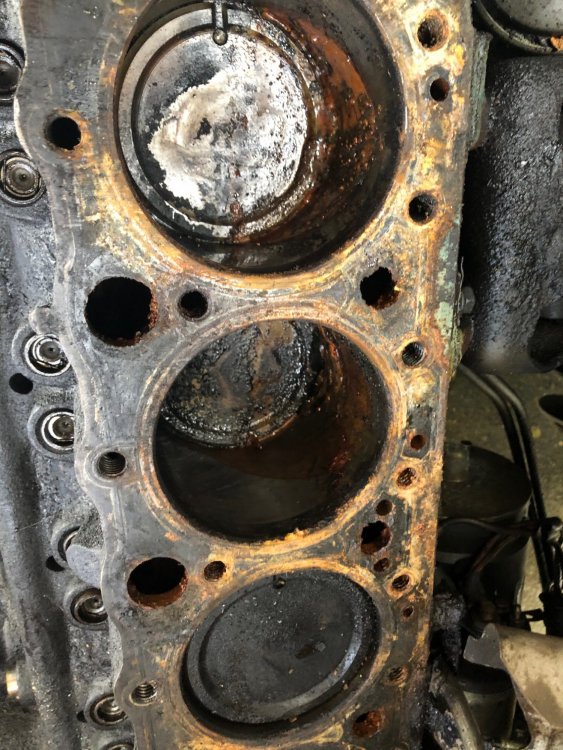

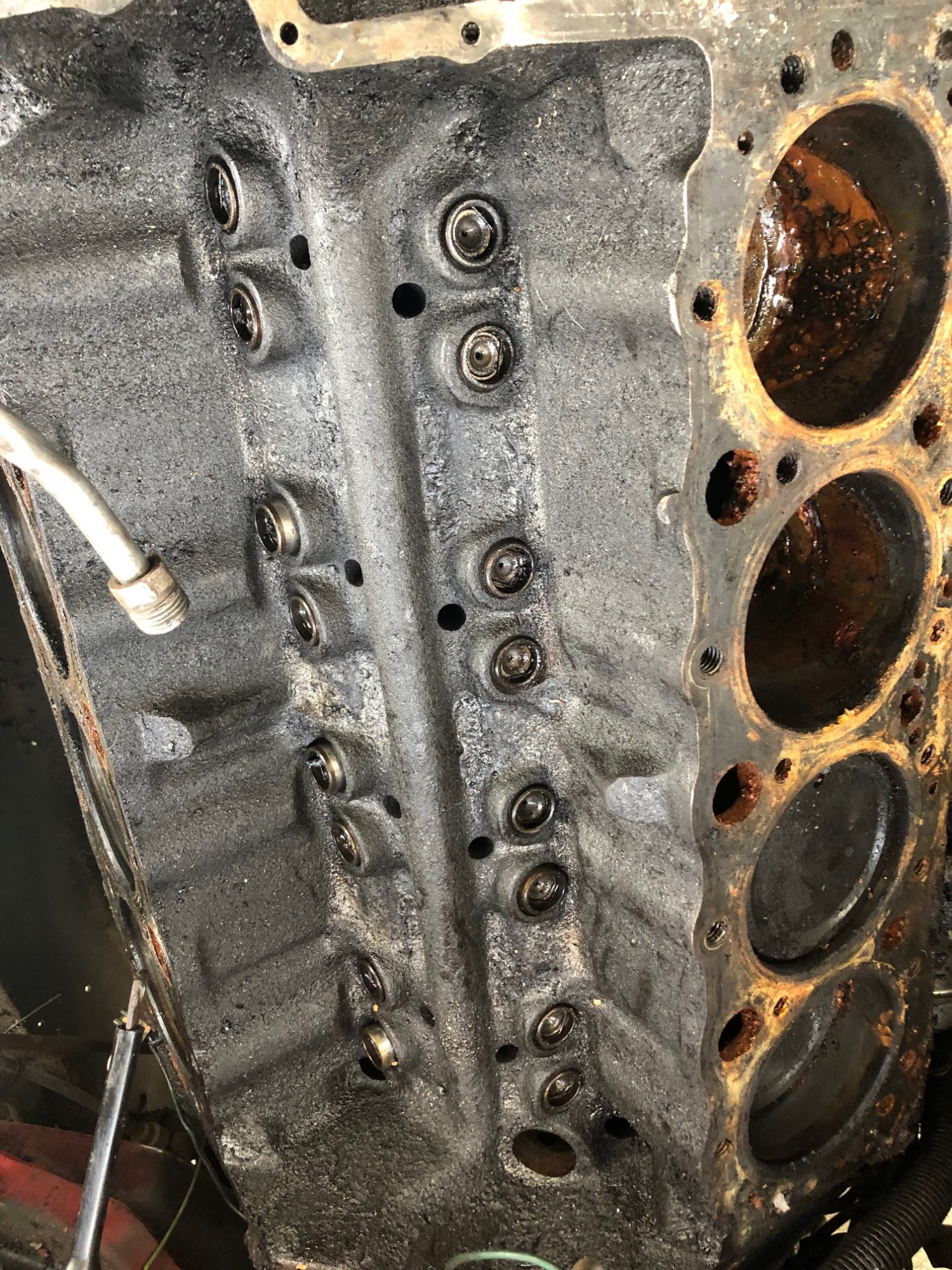

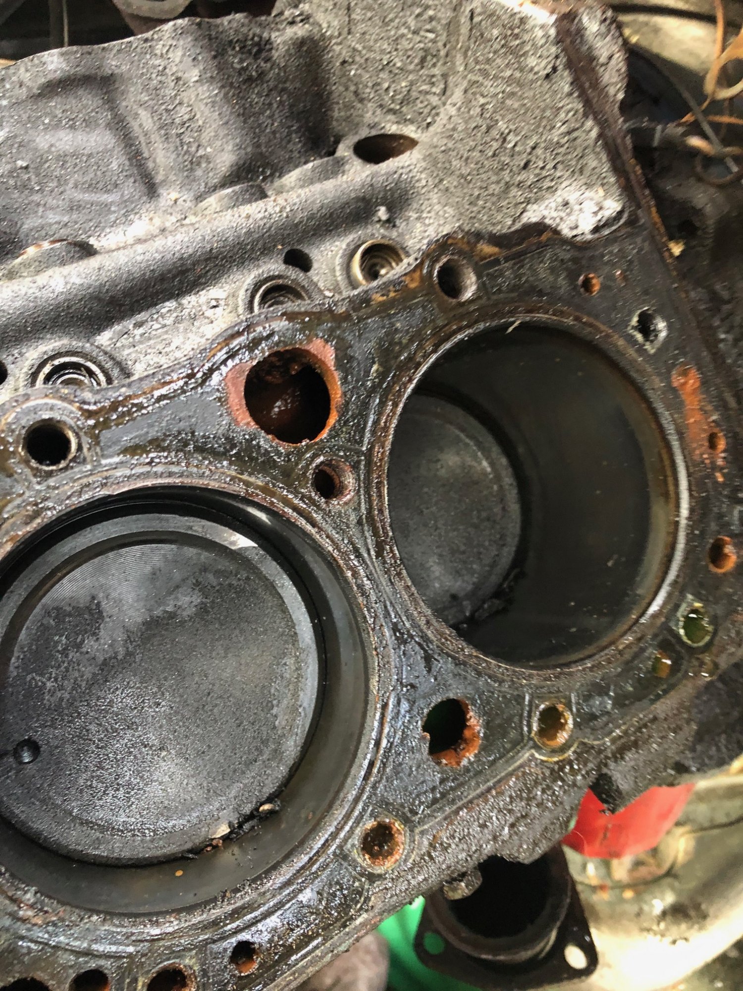

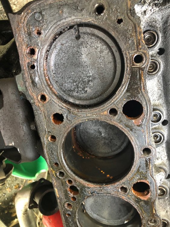

I have a 1980 Chevy C10 small block V-8.
I've removed the valve covers.
Two main questions
  • How do I examine the valve covers, engine block and piston gaskets to know if there are any major issues with them?
  • How do I clean 40 years of gunk off?

I'd pull it apart. Then take it to a machine shop. Have it vatted to clean it. Then it can be inspected. It's going to need machining
Thanks!  Can I take it apart piece by piece, or do I need an engine crane?
Having an engine stand certainly makes working on the engine a lot easier, both with disassembly and reassembly, as it's easier to rotate the engine as necessary to work on the top and bottom as needed.
As for disassembly, check for, and if necessary, add, markings to ensure you know where the part came from and how it came apart (for example, each rod cap goes with a specific rod, and must be bolted together in a specific orientation, you can't mix and match the caps, or rotate their orientation, same with main caps for the crankshaft, and other parts are the same way).  And whatever markings you put on them need to be able to survive being cleaned, as paint markers just wash off...
Quote
As noted an engine stand is necessary, especially for reassembly. You can use a number stamping set to mark rods and rod caps, also for main bearing caps. Mark them on the side where they mate with each other
Note, it's not ONLY those parts that need marking.  I would suggest first reading about the entire process of disassembling/reassembling the engine, so  you know what needs to be marked and what doesn't, and all kinds of other things.  It's a fairly straightforward task to rebuild an engine, but it does require a bunch of stuff to be done right for the result to work well and last for a long time.
Personally, after getting the full-service manual for my truck, and having bought a bunch of Haynes/Chiltons manuals for previous vehicles, I would only use H/C's to start a fire.  They are mostly generic info, with only a small portion begin vehicle-specific info (this is referring to the manuals they sell for your vehicle) and are basically worthless for rebuilding your engine.
The manuals H/C sell for rebuilding your specific engine are more useful, but I would still suggest getting the full-service manual for your truck, either the paper version or an online subscription to it (if the online versions go back far enough to cover your truck).
