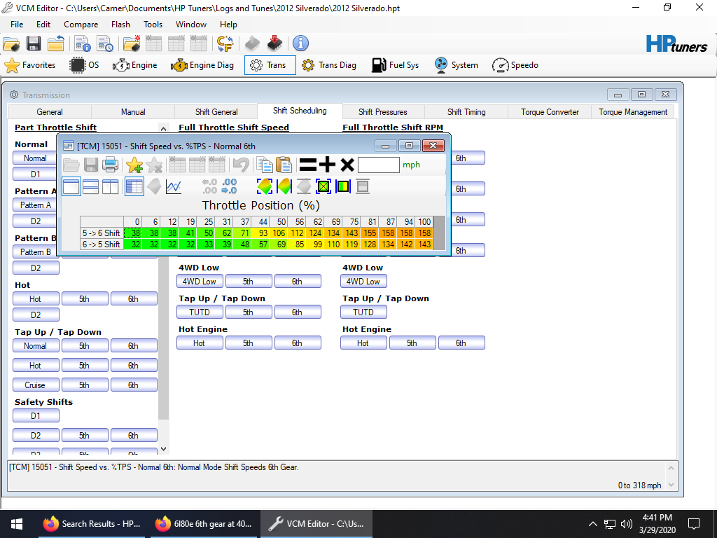

This is a screen shot from a 2012 5.3/6L80e truck. Even with a different rear end gear ratio the results are within 1-3-mph so it doesn't really matter on that part.

I set my 5th gear to 44-45mph and 6th gear at 48-49mph. It never lugs around at 40mph anymore.
I have the same truck as a 2013 and its the same way.  Oddly though otherwise its the most perfect shifting 6 speed truck I have ever driven for the most part.  Just needs some clean up, speed up the wide open throttle shifts and raise the wide open shift points.
I made changes to my one guys 2014 5.3 truck for the same reason.. he hated it going into 6th under light load at such a low speed.  Drastically improved even just mild around town type driving.
