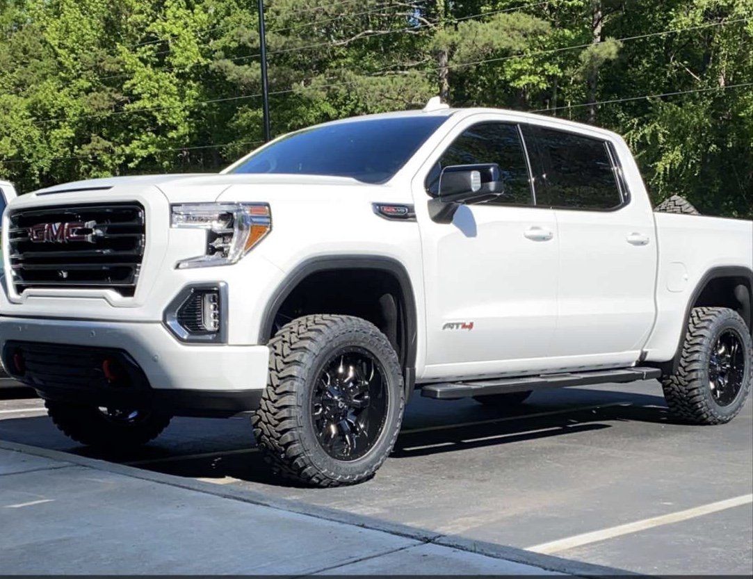

I have a 2 inch ready lift with control arms on my truck. I ran the stock 18s with stock tires and had no issues for about 500 miles before getting 20x10s and 33s.
