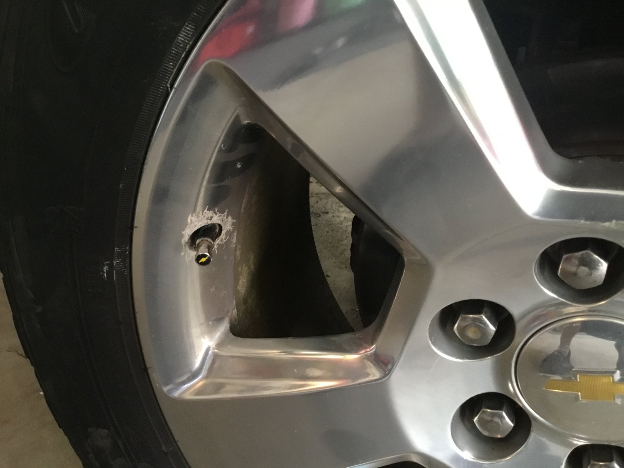

2014 Silverado with polished 20'' rims. all 4 rims are starting to do this. is there any fix or is just because of were i live? makes mad i wash the truck weekly in the winter months. and the truck sits in a heated garage
My guess, where you live.
Salted roads?

yes. unfortunately. goes to N.Wisconsin in winter frequenting pulling sleds. was really hoping for a fix. new rims are expensive.
Allot of alloy polished parts have a clear coat on them that gives up with time. Polymer based. This can be fixed. My local shop sends out to some place in Chicago to have them refurbished. I can try to get a name if you like.

yes please. would like to compare cost of that to getting new ones.
I'll ask tomorrow when they open and get back to ya.

Check with Discount Tire.
They were going to do my old rims. I believe $125 each.
They sent them to another company to do the re-coat.

ok. thank you. lot cheaper than buying new rims
