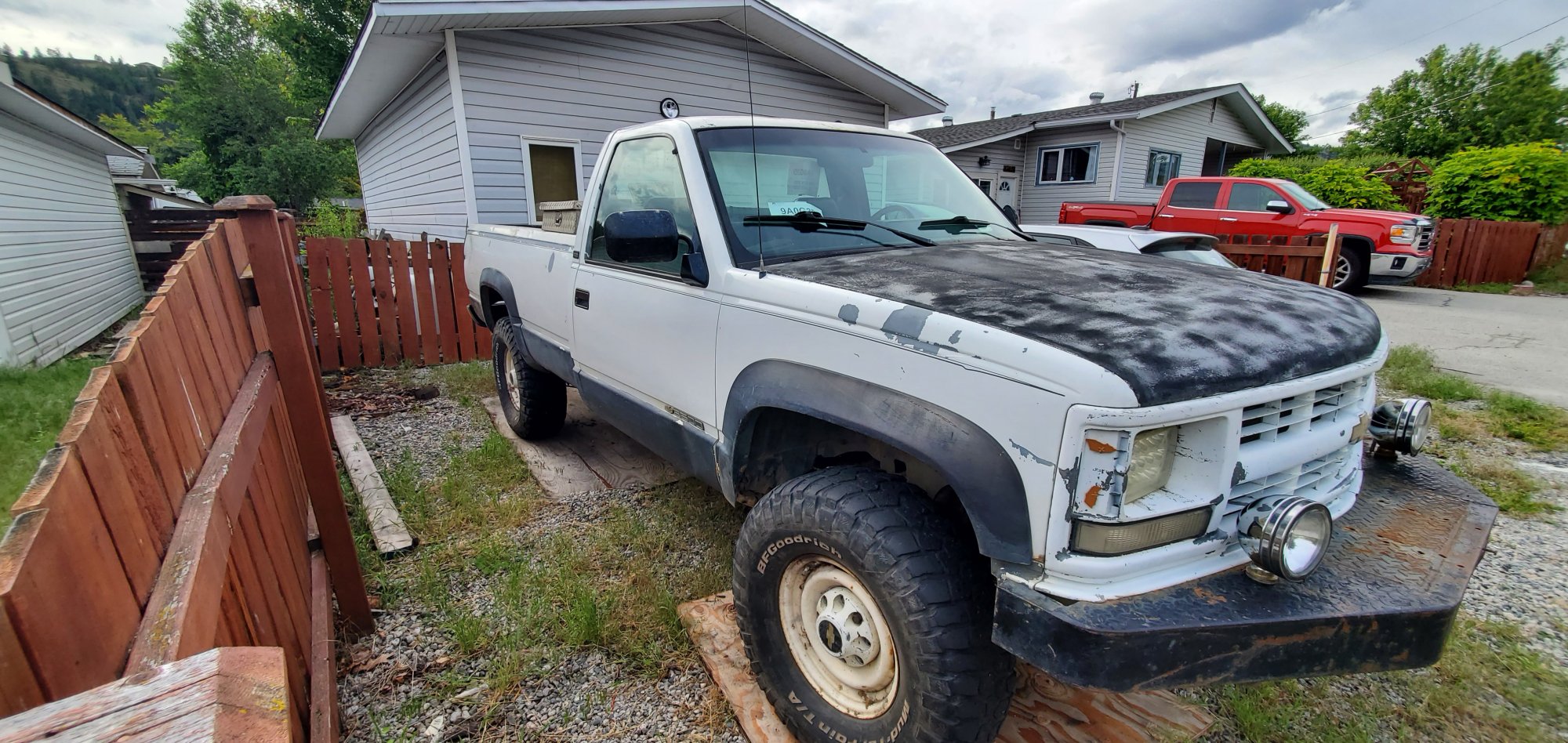

Hi!
So I just picked up a 1994 K3500 Single Cab, with the 454 and a manual transmission also a 4x4! My question is, the kid I got it from has put a janky ass body lift in it and the one on the passenger side rear mount has now pushed its way into the bottom on the cab. What year of Chevy cab can I swap over? I've read 88-94? After 94 I heard the dash is different and won't work? Or whats going to be the best way to fix this? It is a bush rig, I've thought about just leveling it with hockey pucks as I don't have a welder. Any help is greatly appreciated!
If the cab was just the cab it would be 88-98. You can swap your dash and wiring over to the new cab.
A cab with wiring and dash changed several times through those other years though. 1988 to about 1991 or 1992 used a different cluster than the trucks up to 1994. Then 1995+ should have got the better dash and cluster layout.
