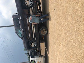

I can say that I am not impressed with my recent purchase. While the truck looks good in my driveway, it has not left a favorable impression on me as a newer Chevy truck owner. I have not had it 1 month and it has been in out of the repair shop multiple times. The first time the check engine light came on and the battery was replaced, the second time I took it back to the dealership I purchased it from and they kept it almost 2 weeks to mimic what I stated during my visit. An ECM was replaced on the the vehicle. 1 road trip to Mississippi and the check engine light came back on and I had no power or ability to go above 45 mph on the highway. Good thing I was not run over by the semi behind me while I attempted to pull over. Lord only knows what will come about during this repair visit in Batesville Ms. Disappointed with no truck in Louisiana.
