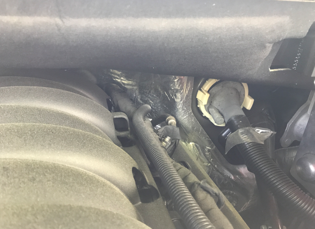

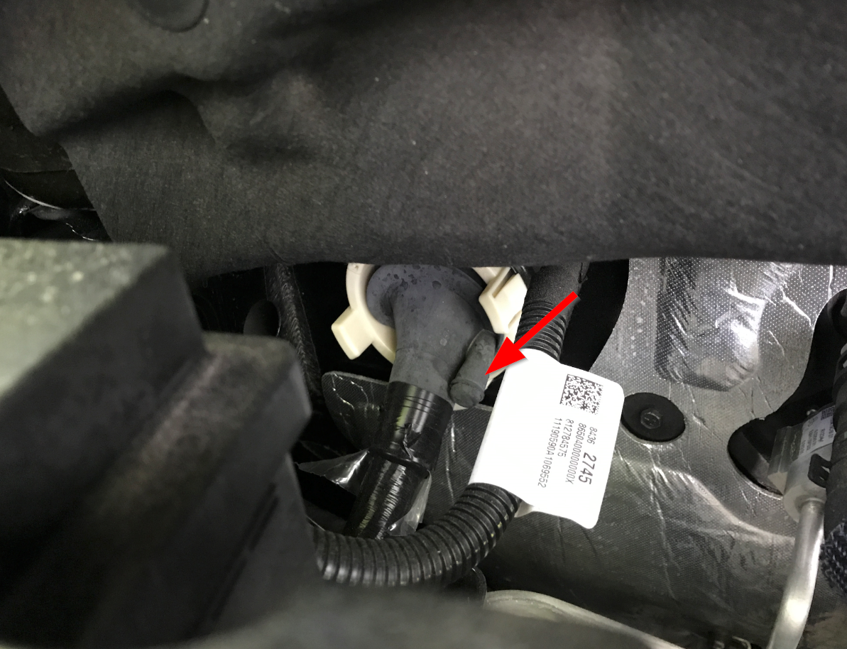

I've seen a better pic of this somewhere here, but can't find it.  On my 2019 there is a passthrough nub on both driver and passenger side.  Some indicate there is no passthrough  nub as indicated in this thread.  Also, I assume GMC would be the same.  I'm familiar with the Chevy.
EDIT  I found the pic I made of mine.  I haven't had the need to use mine, but I understand you cut this front tab off and it fishes right through or maybe poke a hole big enough for the wire to pass.  Then use a bit of sealant at the entry point to seal it up.
Drivers side here. Dam pollen.
