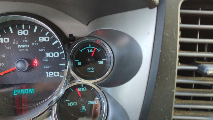

So a couple months ago my dash on my 2011 Silverado lit up and then went dead so I figured it was my alternator and bought a new one.   Fast forward to now and it did it again the other day so I warrantied the alternator and still no fix.  When the issue is in its milder form the service traction message shows up.  I noticed that the voltage runs over 15 on startup and when it gets bad I noticed it kept climbing and the I'm guessing ECU protection kicks in and the truck shuts off if in park.  I had my live data scan on ECU voltage but missed how high it got before shutting down.
Bad battery?  I still need to do. Battery load test.
I'm pretty good at figuring out and doing all my own stuff but this one has me stumped since I think the alternator regulator is ECU controlled.
Thanks in advance for any help.  (This is my first post)

could be a bad connection between the alternator/battery/truck (either power or ground), or battery or ecu or possibly other things.  You need to diagnose where the problem is.  I don't know what the diagnostic procedure for it would be for your truck.
You might consider getting a subscription to the full-service manual at a site like alldatadiy.com
Thanks, I'll have to check that out.  I did throw a battery in it this afternoon at work because I did a load test and the one in it was questionable.  It never had any problems starting though.
After the new battery it did climb up a little high right around 15 volts but then went back down sooner than before.  I'll monitor it on my ride home and go from there.  Fingers crossed although I have my doubts.
I'll keep my findings posted as I find out.
Thanks,
Andrew
Ok so update: I did find that when I connect my scanner to check nthe ECM voltage, as soon as it makes the connection shortly after plugged in to the OBD port that is when all the lights/messages pop up on the dash and all the guages shut off.  Also, AC, radio, signals etc also lose power.  It does retain power to the windows and headlights.  Once I unplug my scanner, everything on the dash goes back to normal.
Anyone ever experienced this? (Or find a fix)?  I need to check more grounds and fuses, but hopefully it's not a bad ECM...
I hate electrical gremlins...
Andrew

Also, I forgot to mention, even though the dash and other things get shut off, I am still able to access and scan codes/live data.   Until it decides to shut down the entire system.  Then I need to unplug the scanner to restart.
