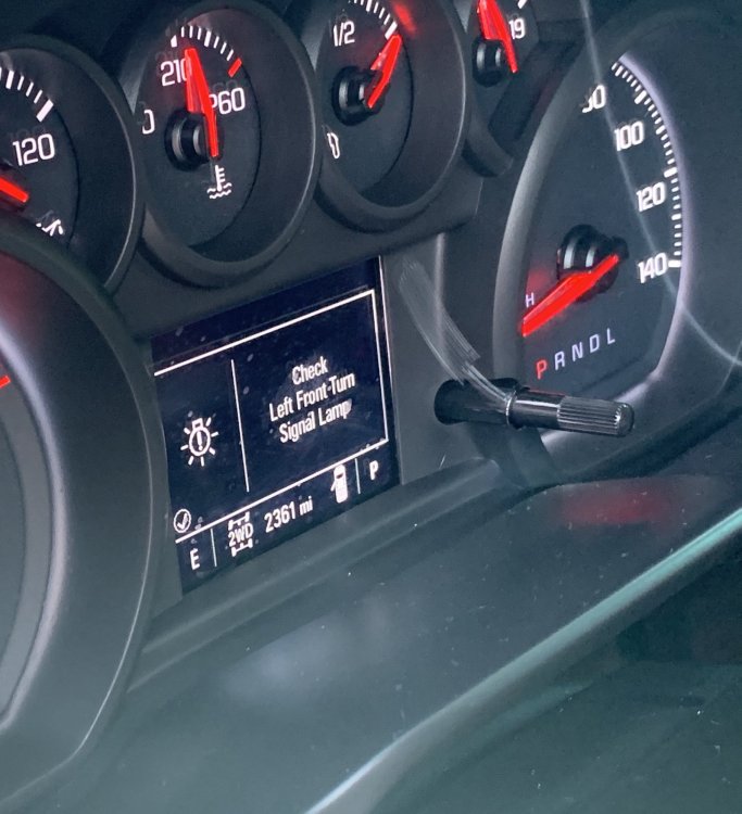

I ordered these from Lasfit: Link
They said the bulbs would work.  They don’t light up and I get a code.  Has anyone successfully put bulbs in that work and don’t hyper flash?
Truck is a GMC W/T

I assume you've taken them out and rotated them 180 degrees? Some LED's only work in one direction.
Wow, I feel like a moron.. that’s why I try not to do anything (even simple) after work.
That worked, appreciate it!
