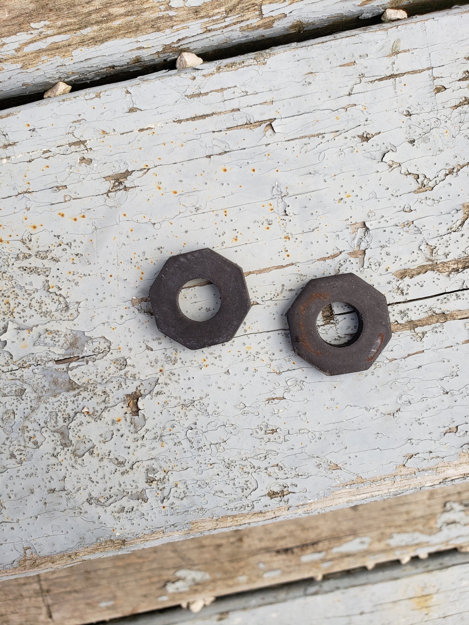

I am replacing my steering column and I seem to have 2 spacers/washers (see picture) that I found on the floor underneath the steering column  and I have no idea where they go.... they must have fell when I took the column out but not sure from where. A YouTube video talked about 2 spacers at the back but doesn't show the guy putting them at their place.
Any help would be greatly appreciated.
From what I could find on the net, I believe the GM part number is 14074908. There are some listed on ebay and they look like the two in your photo. For placement, see number 019 in the list and number 19 in the diagram at this link...
https://nemigaparts.com/cat_spares/epc/gmc/57c-k/06/tc06-907/
This is for a GMC Sierra, but same as a Silvy. Hope this helps.
This is awesome, thanks. I thought it was either at the back of the 2 back or the 2 front support nuts but that creates 2 different angles and didn't want to mess it up.
Thanks again and Happy Thanksgiving!
