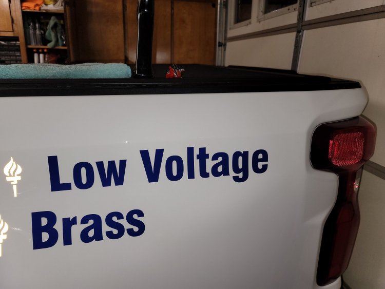

It wasn't as hard as I thought it would be. It looks much better now with the other lettering on the side of the truck ("company" vehicle).

I did a complete decal and de-badge of my truck and it took right about an hour.  There were duramax, Z71, and LT badges all over the vehicle.
