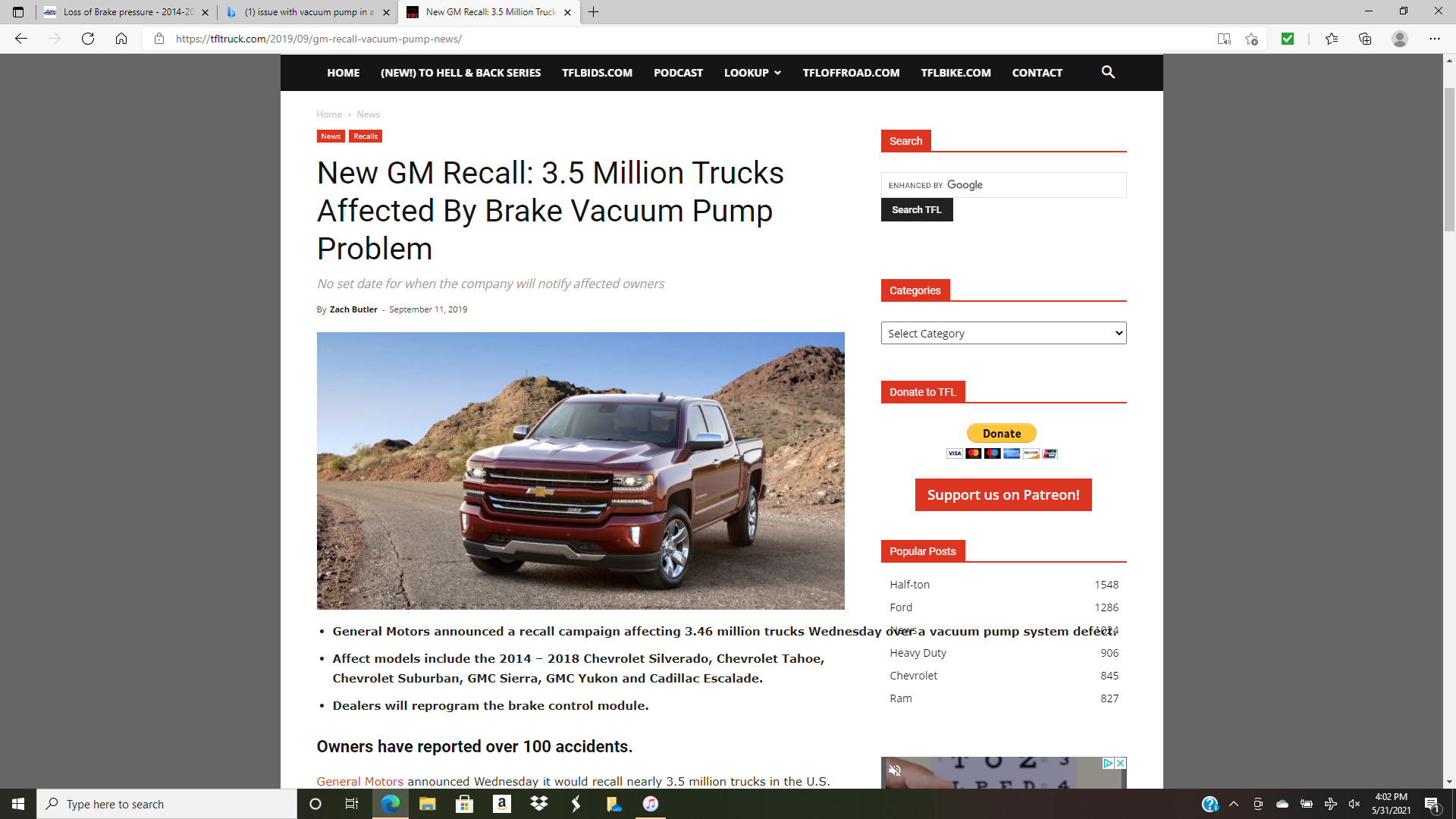

mjm-1957- I'm really hoping there is not a need to replace the master cylinder, but I have considered the possibility
JimCost2014- With more research, I have looked into the problems with the vacuum pump.  It seems as likely an explanation as any.  I also did some research on the NHTSA site regarding complaints about brakes on Chevy trucks.  2 complaints specifically mentioned backing a boat, either down a ramp or to park it in storage. One of those complaints said Chevy replaced the vacuum pump at Chevy's expense.  Hopefully I will have the same luck.
I forgot to mention, I have had a loud ticking coming from the driver's side for most of the life of the truck.
