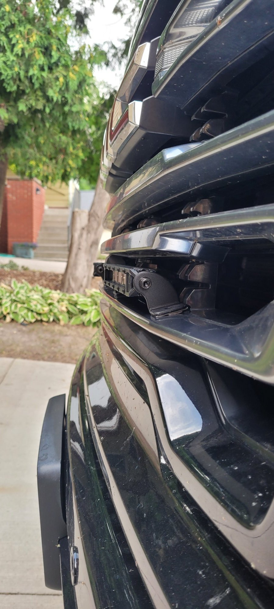

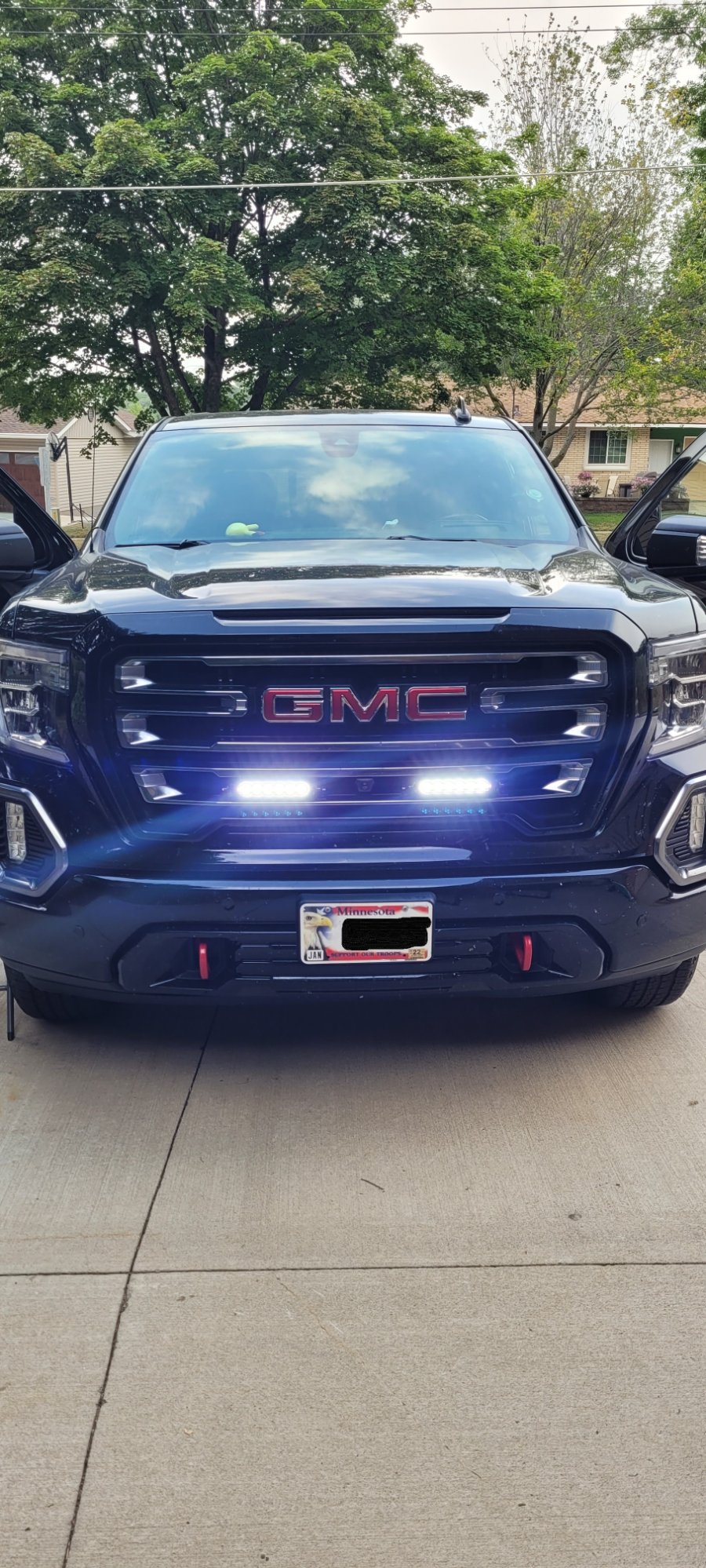

Did a little install today. Got some 6" Slim Rough Country led light bars black series. I found a spot where they fit pretty nice and almost completely tucked in the grill. They should help light up a bit more when I'm off-road or out on the frozen lakes ice fishing. They only stick out a half inch if that. I found a good spot on the passenger side behind the battery to get through the fire wall. There is a rubber nipple that you can cut and push the wires through (Had to use a metal coat hanger to shove them through) and run them to the drivers side for the switch install. From looking straight on they look hidden pretty good. I am happy with the way it turned out. I just need to get a stainless self tapping screws to secure it to the grill. I have 3M double sided auto tape holding them on at the moment.
