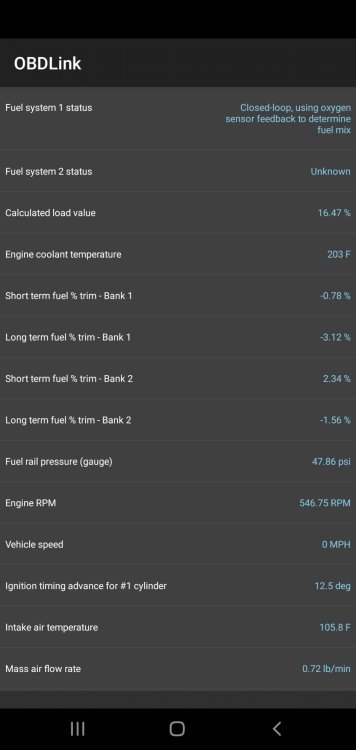

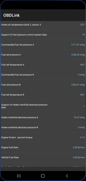

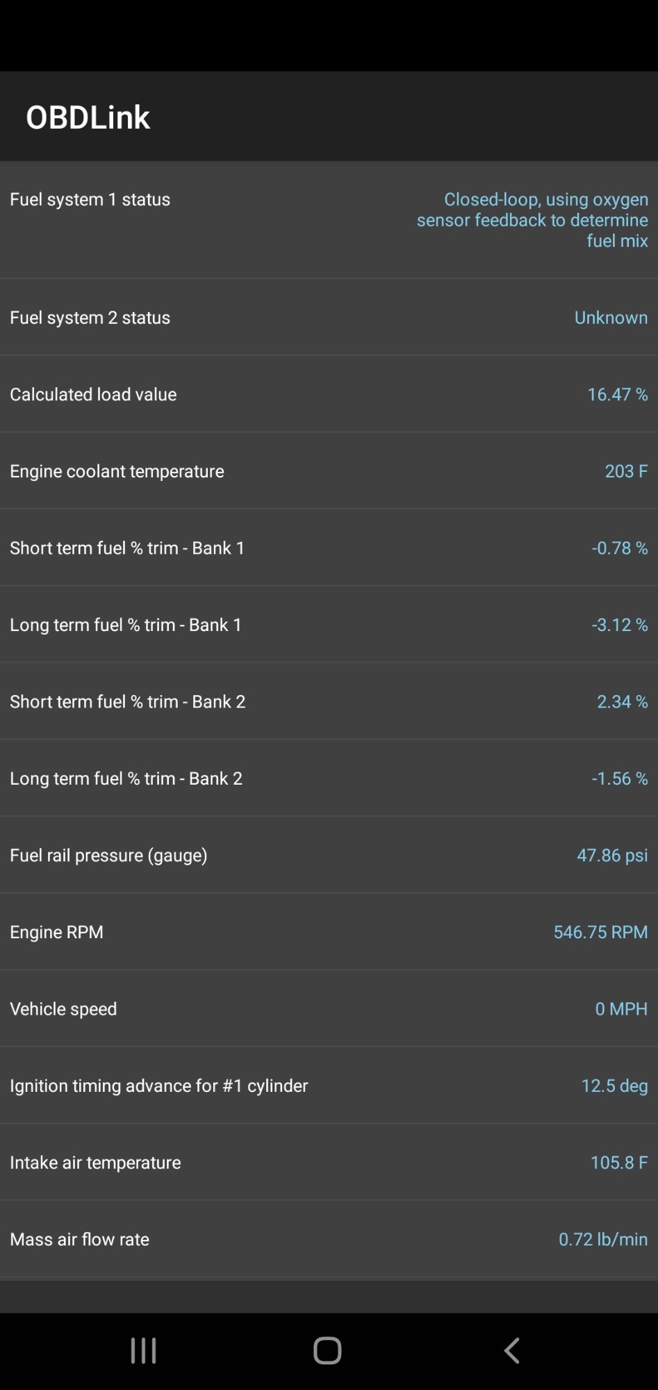

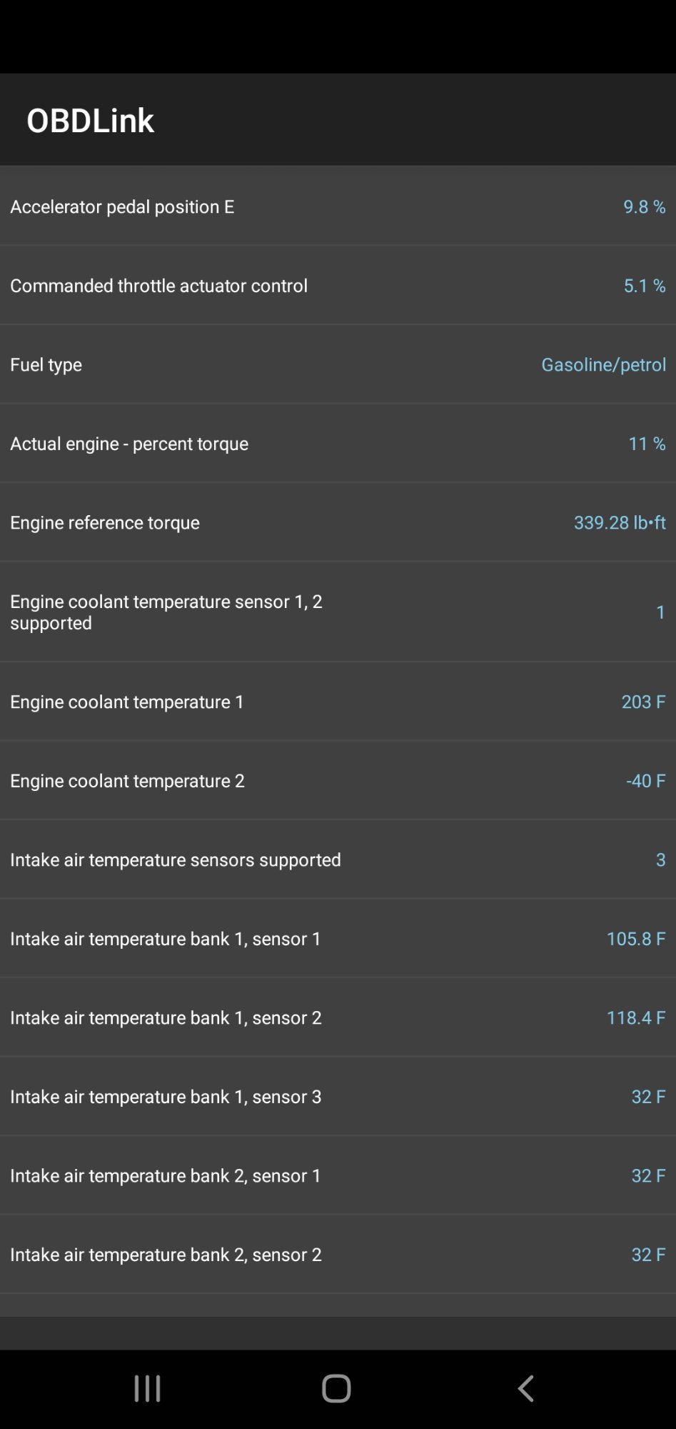

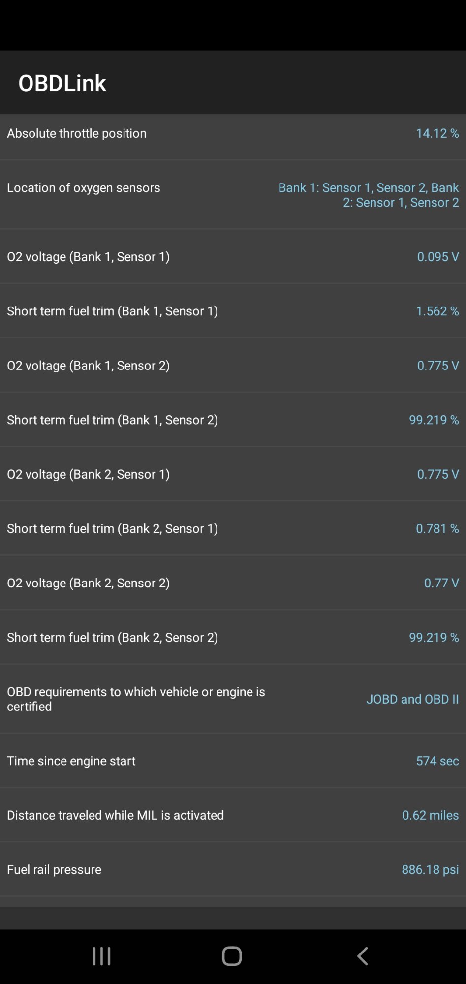

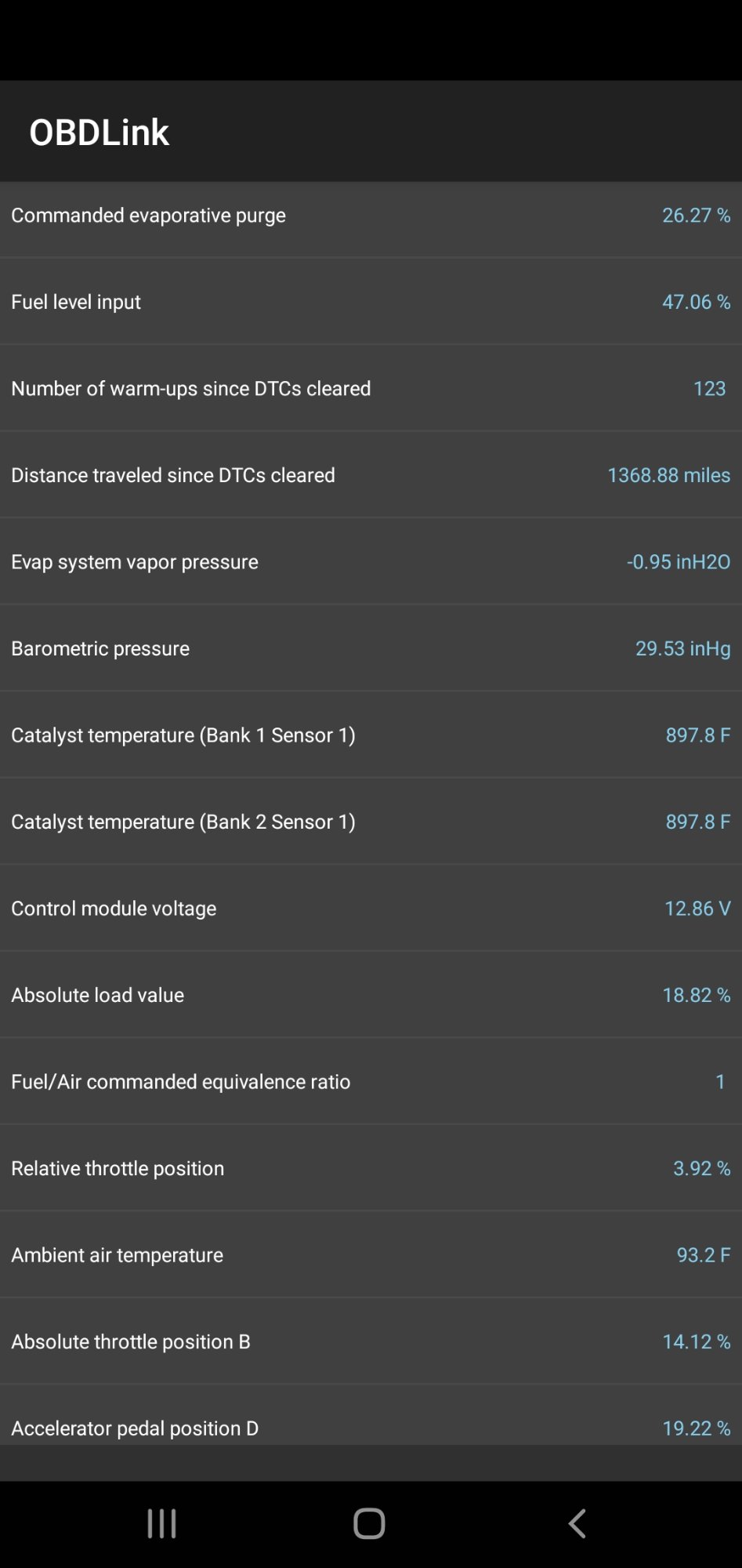

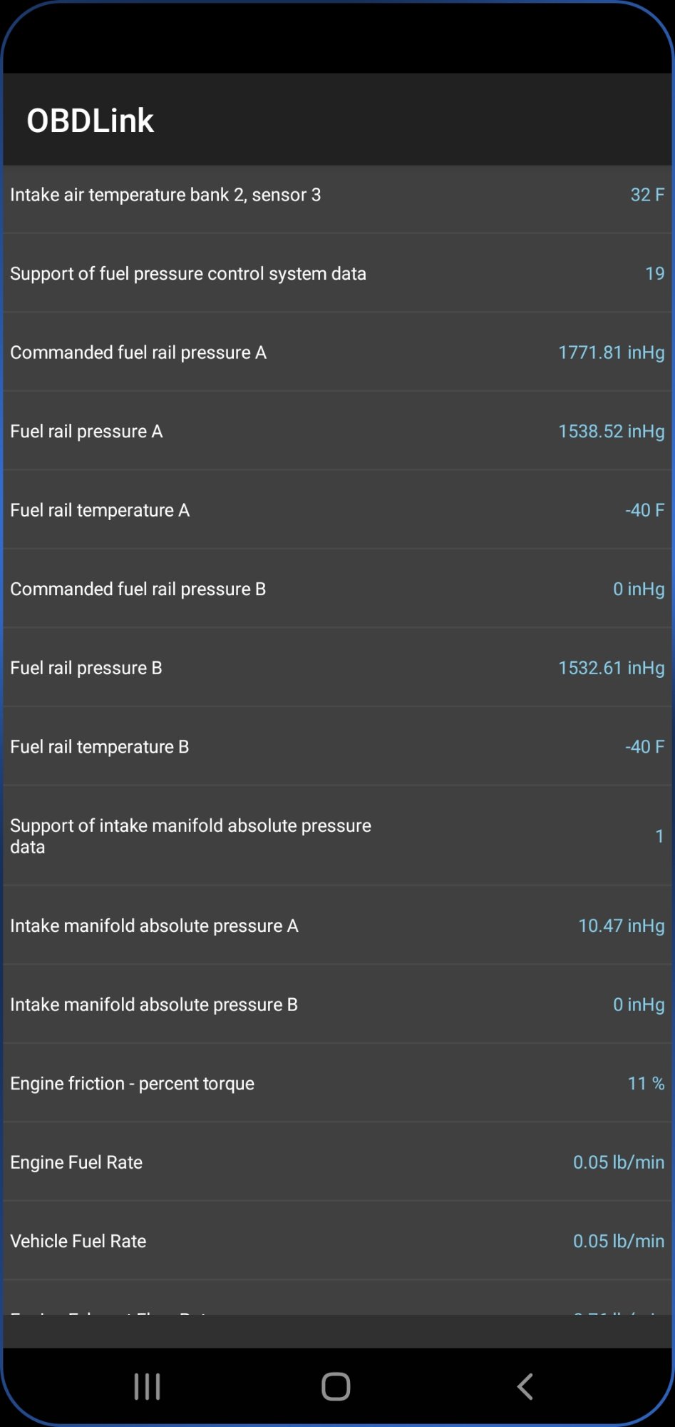

Here's some screenshots of the 2nd scan yesterday with the snapshot data of what was occurring in the ECM when the truck misfired. Maybe someone will notice something I didn't.

Yes I have the 10 speed. They HAVE NOT done that update yet. My plan is to demand they do it today. This has gone on for too long. Thanks for the advice. Interesting, didn't know there may be a 10spd issue. Thanks for that.
