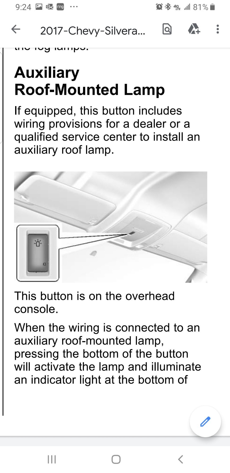

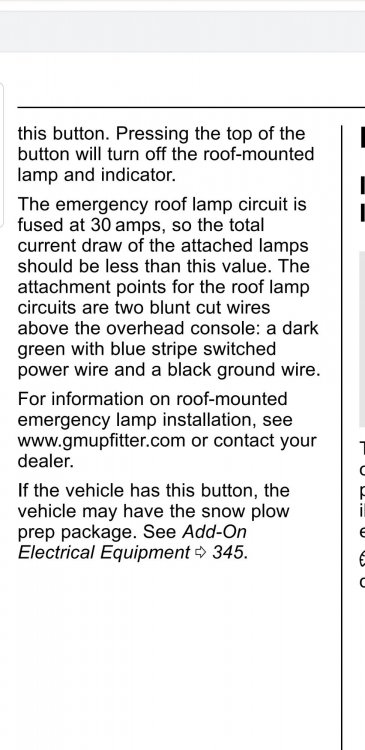

@lovecars I have 2017 1500 WT with the Auxiliary Roof-Mounted Lamp option. There might be a part of your harness that goes to where that switch would be in the upper console/ map light area. If so, you could get power from there. You may have already solved your problem by now though.
