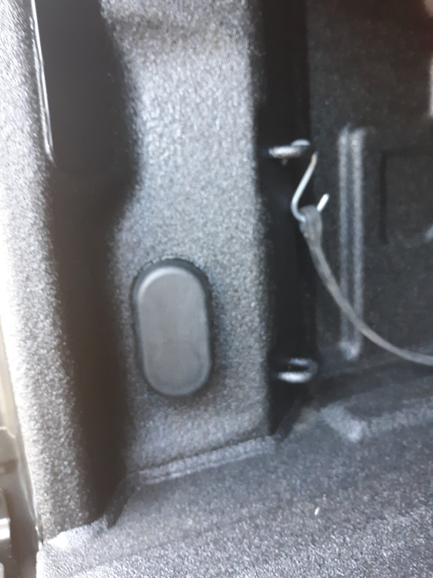

I want to install a 12 volt outlet on the bed of my 2022 2500HD Silverado. Before I pry it of, what goes in this oval shaped plastic thingy by the tailgate?
I believe that is for the wiring that goes to the gooseneck/5th wheel connection.  On the other side of the bed, if you have a cover on there, that is where the 110v outlet would be.
Curt makes wire bundles with connectors compatible with GM connectors. You end up buying a 7 or 10 foot wire harness with connectors, and don’t use the panel mount trailer connector that comes with it. You separately buy the oval panel mount connector, and the Curt harness plugs into the back of it. The other end of the harness had male and female connectors wired in parallel and those connectors insert between the bumper connector and its harness.
7 foot harness Curt 56070
Panel mount oval connector Hopkins 40974
